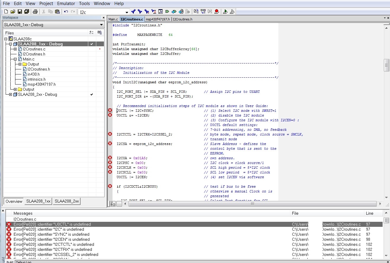

  • Having a deeper look at the EEPROM Examples via I2C, found the following one.
    http://www.ti.com/lit/an/slaa208a/slaa208a.pdf
    http://www.ti.com/lit/an/slaa208a/slaa208a.zip  ==> the code
    I use MSP430F47197 which is a member of MSP430F4XX family. However, this example gives me the code for MSP430F2xx. As you can see from the following figure, I just simply changed the header file to 4XX and seems the compiler is not happy with I2C initialization!
    My question is that how I can get the initialization tailored to 4XX. If I go one by one that would be so time-consuming!
    Is there any way to get around with this?
  • >I use MSP430F47197 which is a member of MSP430F4XX family. However, this example gives me the code for MSP430F2xx.
    You shall get i2c examples of 4XX chip to familiarize with i2c low level use of 4xx peripherals. Then supposedly you shall be able to "port" EEPROM appnote to 4xx chip.
  • Yes, seems no choice left! The initialization is totally different! however, when it comes to 4XX there are only MASTER-SLAVE examples left! No CPU to EEPROM!
    Let's see how I can get my CAT24C02 EEPROm to work! Seems setting the right interruption acts an important rule to WR/RE into/From EEPROM!

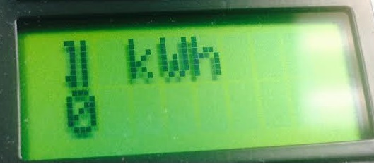

    Therefore, I believe that if I call the function from the main, I can get access to the EEPROM! Right? However, what it is confusing is that why some functions are defined as 'Static'?!!!!   in the iiceeprom.c?!
  • Well, actually please disregard my question above. I realized that I do not need the 'Static' functions as they are used within "icc" file. So I just need to use the following functions.
    iicEEPROM_init();
    iicEEPROM_write(address to save, Data to write, length);
     iicEEPROM_read(,,)
    However, I am not quite sure that why I need the data argument to read from the address?!!!!!
    The Reading part is not confusing to you guys?!!!!!! Also, I am not too sure about the length!
  • More specifically, I don't understand what wrong with my code below is?!
     //***************  EEPROM:
             iicEEPROM_init();
             uint8_t *q;
             char dat = 0xFF;
             q = (uint8_t *) dat;
             iicEEPROM_write(0X00, q, 2);
             LCD_cmd(0x80);
             LCD_dat(iicEEPROM_read(0x00,q,2)+0x29);
  • In other words, how can I write into a certain address and read from that immediately?
             iicEEPROM_init();
             uint8_t *dat;
           //  uint8_t *dat1 ;
             uint8_t dat1 = 56;
     iicEEPROM_write(22,  (uint8_t *) &dat1, sizeof(dat1));
             LCD_cmd(0X80);
             LCD_dat(iicEEPROM_read(22, (void *) &dat  ,sizeof(dat)));
             __delay_cycles(8388608*2);
  • Ok, now I realized that I do not need the following line.
    iicEEPROM_init();
    As this is coded in the Setup Section of the firmware. However, I am still confused with Read part!
    How can I address this? I still get nothing on the display!!!
  • "The initialization is totally different!"
    Not only the initialization. The code is for the USART module, as found on 1x family and some 2x and 4x family devices. Your MSP has two USCI modules, which are totally different regarding I2C and somewhat different regarding UART and SPI.
    (there are a few 4x devices which have both, USART and USCI).
    So not only the initialization, but also all register names and the whole way to operate I2C transfers are different.
    On USART, you set-up the module for a transfer, start the transfer and wait until an interrupt tells you about success or failure. This setup is quite complex and effectively useless if you have I2C operations like 'write register address, then read register data'. This is why I wrote my own bit-banging I2C code for the 1232 and 1611.
    On USCI, you manage the high-level protocol step-by-step in software, which is less convenient for large-size block transfers but way more useful for short transfers. or command/response combinations. The eUSCI combines both, giving simplicity for ping-pong transfers while providing convenience for block transfers. However, the eUSCI handling for block transfers is not compatible to the USART.
    If you carefully study the users guide, you'll find a timeline chart for I2C master operation (read and write). It tells you the prerequisites and time sequence in which things happen or have to be done on the USCI. Following the chart strictly should give you working code for writing a register address, writing a register address followed by data to write to this register, and read from a register whose address was previously written. You don't even need interrupts (if your application cannot continue anyway until done). So for most I2C devices with register/memory addresses (including the CAT24C02W) , coding is straight:
    configure port pins
    - write slave address to UCBxI2CSA (7 bit address without R/W bit). For the CAT24C02W, it is 0x50 (assuming A0-A2 being low). For teh 512/1k/2k versions, the LSBs are used to address the different 256 byte segments of the memory as if they were multiple 256b devices.

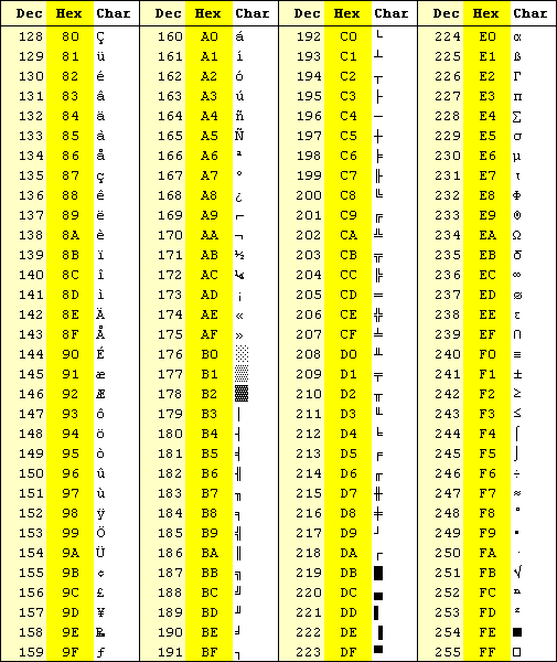

  • Isn't it weird that I got the character which is shown on the below figure when I remove 0x30?!
    There is no such character in the Asci chart!
  • Now your dat is a 16 bit value (uint16_t). That means you're writing two bytes, 0xff to 0xa0 and 0x00 to 0xa1. It is superfluous to cast &dat to uint16_t* as it IS an uint16_t *, the reference pointer to an uint16_t. I guess, the read and write functions are interpreting it as uint8_t* anyway, as the I2C protocol is byte-oriented.
    I don't know what LCD_dat does or expects. Doe sit print a single char, doe sit print a value or does it print a string? No idea. In the last case, it would try to print a string located at address dat+0x30 (perhaps, if the read was successful) 0x012f.
    The ASCII code was not defined for characters above 0x7f. So depending on 'codepage' or such, all characters above 0x7f can show anything. You'll need the font table of your display (or of your LCD driver, if it stuffs the display with bitmap information), to see what code this specific symbol might belong to.
    Yes, that is called "Extended ASCII Table"!
    void LCD_dat(unsigned char byte){  P8OUT &= 0xF8; // EN=0,RW=0,RS=0  P8OUT |= 0x01; // change to RS=1  P7DIR = 0xFF;  // P7 out    P7OUT = byte;    P8OUT |= 0x04; // EN=1      __delay_cycles(2); // Insurance    P8OUT &= 0xFB;  // EN=0  P7DIR = 0;     //  P7 float      DelayMs(3);}
  • __delay_cycles(2) might be a bit short. I tis only adding 2 MCLK cycles. If you ever speed-up the CPU in the course of your project, it might become too short for the LCD. Otherwise, yes, passing dat to the function should show the character that corresponds to the lower 8 bits of the integer dat.
    Regarding the character code, yes, characters 128 to 255 belong to the extended ASCII table, but there are plenty of different versions of this extensions, the so-called codepages. Each one shows completely different characters, and it is not sure whether your LCD even implements one of these at all, or maybe its own collection of symbols. (similar for the character 0..31, which are defined as function codes, not printable symbols).
    Those who have experience with DOS on a PC, and especially those who live in a non-English country, will well remember the codepage confusion.
    So unless you don't have a printed manual showing you the symbols above 0x80, you don't know what's right or wrong. So better test with something below 0x80.
