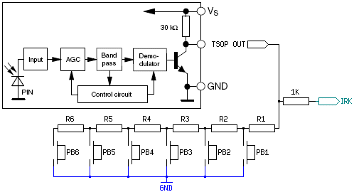

    Here is my keyboard for MSP430G2xx...
    When signal on IRK (ADC) pin goes to logic zero, ADC is turned on, and start collecting samples. After 100 samples is collected, they are sorted, and average value of 8 mid samples is calculated. Depending on avg calculated value pressed key is decoded.

    Can R1..R6 all use the same value ? (e.g., all 2.2k) Or, do they need to have different values ? (Smaller for R1 and progressively higher toward R6.)
    Only "logic zero" interval is used, half of ADC resolution. In ADC resistor array is is included TSOP (close to) 30k internal resistor. I suggested resistor values, but it up to end user, because there is learn key function, and target device is able to recalibrate keyboard anytime.

    This is incorrect.
    When PB2 is pressed, R=R1+R2. When PB3 is pressed, R=R1+R2+R3. etc.
    Also,you could use 1.5V Ref.
    This is incorrect.
    When PB2 is pressed, R = R1 + R2 = 1322 + 2483 = 3805, ADC value 1023 * 3805 / 33805 = 115
    When PB3 is pressed, R = R1 + R2 + R3 = 1322 + 2483 + 2911 = 6716, ADC value 1023 * 6716 / 36716 = 187
    As ref is used VCC/VSS because target device voltage is not fixed, it is selected (2.5V - 3.3V) by end user. And want to keep same ADC values, not depending on selected VCC.
