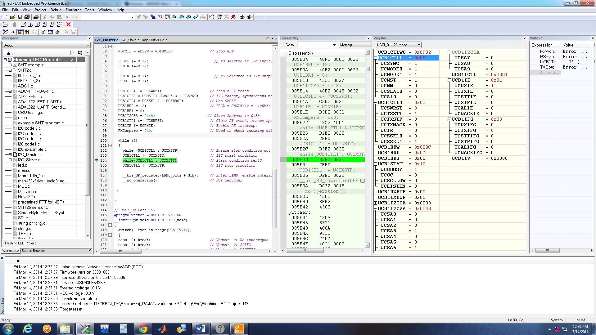

    i am using IAR compiler. when i run master code in on mSP430F5438A board, it is waiting for start condition
     while(UCB1CTL1 & UCTXSTT); // Start condition sent?
    i am attaching my snap shot of my setup.

    more over, when i am running my master code, my code is waiting this condition.
    and UCBBUS was set
    i am attaching my snap shot, when program was waiting at that condition.
    It seems like you have 3 different Vcc sources going on - I could see this causing issues (looks like you have a bench supply, the FET tool, and the USB power all being used). It might be good to try supplying everything from the same supply. I have seen I2C communication be kind of flake-y before when the two boards are supplied differently, because if everything is not at quite the same level then the thresholds being used for 0 vs 1 on the boards might be slightly off from each other and cause problems.
    You should probably also take an oscilloscope and observe what is happening on your SDA/SCL lines. Seeing your setup you have very long cables and a breadboard all involved, which is not going to help with your I2C communication because in I2C the two boards are both having to control the same lines, just pulling down against the pullup to cause the communication, and then the pullup is the only thing to pull the line high - if you look at it with a scope sometimes your waveform may look really curved (too slow of rise/fall time) like an RC signal, instead of having nice edges, and this may be why you have troubles. If that is the case you can try using a different pullup resistor value, or shorter wires, etc to try to improve the waveform. Sometimes you can also try using a slower communication frequency setting, so that the rise/fall time is a smaller percentage of your bit width.
