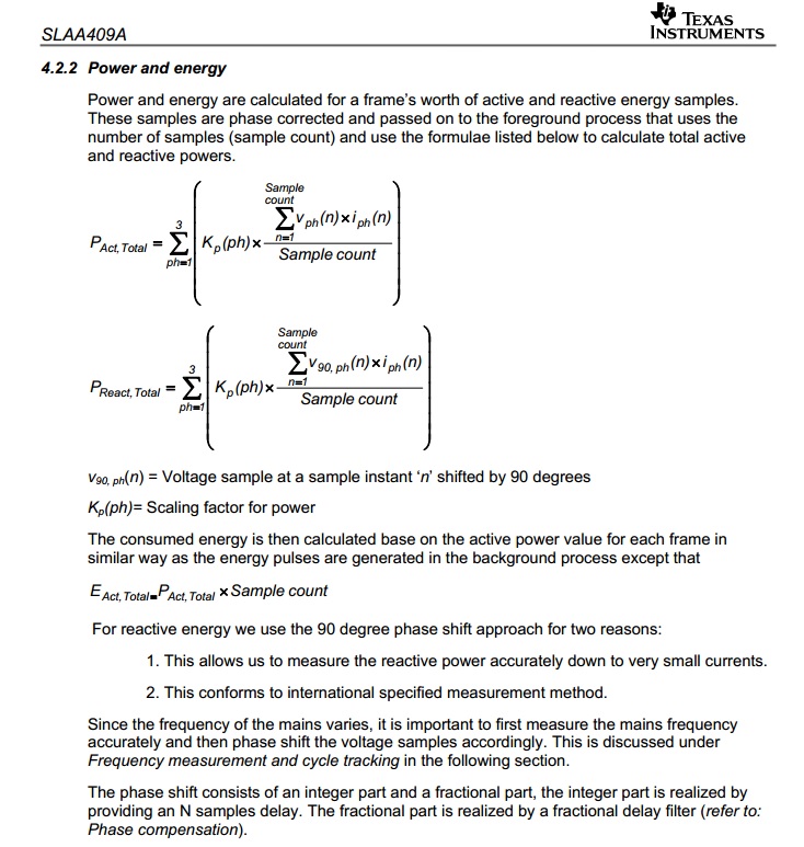

Resolution problem 3 phase energy meter MSP430f47197 (NOT answered *** TI Employees attention plz!)
I am wondering if I can increase the resolution of kWhs on the following product. I changed the resolution factor and applied different changes on the Background as well as Foreground parts but still no success. Please guide!
http://www.ti.com/general/docs/lit/getliterature.tsp?literatureNumber=slaa409a&fileType=zip
http://www.ti.com/general/docs/lit/getliterature.tsp?baseLiteratureNumber=slaa409&fileType=pdf
  • Through the code I found the followings.
    #define VOLTAGE_RESOLUTION                          2
    or
    #define ENERGY_RESOLUTION                           2
    And also:
    #define VOLTAGE_DIGITS                              4
    However, by changing them, nothing is changed! Maybe somewhere the display code does not hsow the values properly! I am still working on it!
  • Also according to the following documentation. I tried to change the Scaling factor and sample count. No success! Maybe the register are truncated somewhere or resolution does not go higher!!! I am not sure which quantity should be changed in order to get a more resolution.
    http://www.ti.com/lit/an/slaa409a/slaa409a.pdf
  • Seems adjusting Vrms and Irms values are doable but when it comes to product of those and get a P is not easy to change the resolution!
  • To measure energy consumption, you need to integrate over time the product of voltage * current.
    To measure the voltage, the resolution and accuracy depends on the voltage divider resistors, the reference voltage and the resolution of the ADC used. What is the accuracy of the divider? What is the range and resolution of the ADC?
    To measure the current, the resolution and accuracy depends on the CT (or shunt resistors), the reference voltage and the resolution of the ADC used. What is the accuracy of the CT (or shunt)? What is the range and resolution of the ADC?
    To integrate over time, you have to use summation at fixed intervals as an approximation. What is that interval?
    Without improving the above three elements, you cannot get meaningful results even if you carry out the calculation to very large number of bits without truncation. Truncation is often used to save calculation time by ignoring meaningless bits. If you do not do that, you might prolong the summation interval and thus get worse results and only gain some meaningless garbage bits in the result.

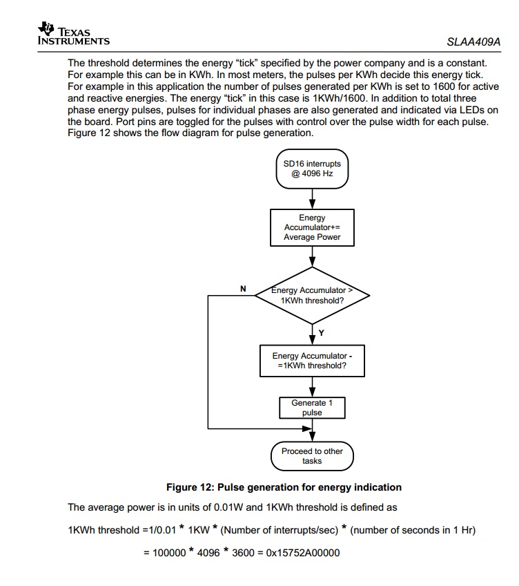

    I notice that they had used bite-wise shift, then I could able to get more decimal points. As for the ADC they have used 16-Bit Sigma-Delta and as Accuracy it says:
    #undef FINE_ENERGY_PULSE_TIMING_SUPPORT
    ! This enables the generation of total energy pulses to an accuracy of 1/32768s, instead
    of 10/32768s, when building meters using the ADC12 ADC converter.
    And pge 12 of
    The SD16 converter is self triggering at a sampling frequency of 4096 samples/sec.

    I am not sure about the interval that you are talking about but they have used the following method:
        #if defined(INHIBIT_NEGATIVE_TOTAL_POWER_ACCUMULATION)
            if (total_active_power > 0  &&  (total_active_power_counter += total_active_power) >= TOTAL_ENERGY_PULSE_THRESHOLD)
        #else
            if ((total_active_power_counter += total_active_power) >= TOTAL_ENERGY_PULSE_THRESHOLD)
        #endif
                total_active_power_counter -= TOTAL_ENERGY_PULSE_THRESHOLD;
        #if TOTAL_ENERGY_PULSES_PER_KW_HOUR < 1000
                if (++extra_total_active_power_counter >= 16) // was 16
                    extra_total_active_power_counter = 0;
        #endif
                    ++total_consumed_active_energy;
                    /* Ideally we want to log the energy each kWh unit, but doing
                       it with a mask here is good enough and faster. */
                    if ((total_consumed_active_energy & 0x3FF) == 0)
                        phase->status |= ENERGY_LOGABLE;
                    /* Pulse the LED. Long pulses may not be reliable, as at full

  • OCY,
    I don't understand the "product" part ...when I have voltage to 5 decimal points and current to 5 as well, there should be a register which exclude those numbers and I have only 2 decimal point of energy!
    Even though, you mentioned that the resolution and shunt registers and that time interval is important, I believe that it is not that much out of reach to get at least 4 decimal point of energy! Then I can calibrate it and compare it with a standard meter in order to see if I get an accurate values! Right? But understanding the code which is written by someone else and with many C and h file is not an easy job!
  • Let's say in the Active Power section we have:
    #if defined(SINGLE_PHASE)
    int32_t active_power(void)                  // Active Power --------------
    #else
    int32_t active_power(struct phase_parms_s *phase, struct phase_nv_parms_s const *phase_nv)
    #endif
        int32_t x;
        int16_t i;
    #if defined(NEUTRAL_MONITOR_SUPPORT)  ||  GAIN_STAGES > 1
        int32_t y;
    #endif
    #if defined(PHASE_REVERSED_DETECTION_SUPPORT)
        int reversed;
    #endif
        /* We can only do real power assessment in full operating mode. */
        /* If we have neutral monitoring for a single phase meter, we need to measure
           both power levels, and decide between them. Issues to be assessed here are
           whether one or both leads show reverse power, and whether the power levels
           are balanced. */
        /* If we find a negative power level we may be genuinely feeding power to the grid,
           or we may be seeing a tamper condition. This is application dependant. */
        reversed = FALSE;
    #endif
        x = div_sh48(phase->metrology.current.dot_prod_logged.P_active[0], 31 - 2*ADC_BITS, phase->metrology.current.dot_prod_logged.sample_count); // 27 to 32
        i = phase_nv->current.P_scale_factor[0];
    I found the following for  dot_prod_logged.
     struct current_sensor_dot_prod_set_s dot_prod_logged;
    But have no idea how they calculate this product macro!!!
  • By “product”, I mean the result of multiplication.
    I am neither an engineer nor a programmer. I do not know (nor care to know) the specifics of the energy meter you are talking about.
    Assuming that it is a “230VAC, 100Amp Service” energy meter commonly used in residential household, it must be able to measure the 100 Amp full load.
    If a 16-bit ADC is used, this means the ADC reads 65536 counts when the current is 100 Amp. Thus the least count of the ADC is about 100 / 65535 = 0.0015 Amp.
    To me, the above means when the current is less than ~0.0015 Amp, the ADC reads 0. And when the ADC appears to tells you the current is “x” Amp, it actually means the current is somewhere between “x” Amp and “x + 0.0015” Amp.
    Multiply the current by the voltage to get power. When the power consumption is blow ~0.35 Watt, you will get 0.00000000000000000000 Watt no mater how precise you do the multiplication. And when the multiplication appears to tell you the power consumption is “y” Watt, it actually means the power consumption is somewhere between  “y” Watt and “y + 0.35” Watt.
    Over a month (30*24 Hr) time, when the energy meter appears to tell you “z” kWattHr, it really means somewhere between “z” kWattHr and “z + 0.25” kWattHr. The digits after the decimal point are meaningless.

  • old_cow_yellow said:
    all the other digits (no matter how many) are meaningless even under perfect conditions
    Then we won't get the micro resolution! :(
    BTW, we decide to work on the pulse weight instead of resolution consideration .... still dunno how does it exactly work!
    I hard of pulse height, pulse width, etc. Never hard the term pulse wight before.
    In the context of a particular energy meter, may be (I am just guessing) that meter emits an IR pulse whenever it accumulates a certain fixed amount of kWattHr so that an external device could count the pulses. Is that fixed amount of kWattHr the "weight" of the each pulse?
    By the way, Steven Underwood finally answered one of your many postings. Did you forget that you want to contact him?
    Yes. Plan is to increase pulse granularity because as you did show previously - ADC have not enough resolution. I am just explaining this to you, cow - so you can understand.
  • llmars,
    Thank you. I hope they do not encode the weight in the pulse width or things like that, so that one only need to count the number of pulses.

  • The following is the energy calculation and I believe I need to apply some changes to get more decimal points!

  • It is said that the following DOES NOT AFFECT the process of Accumulation. I know it fills up the bucket but what is the way to change the process then?
    /*! This sets the number of pulses per kilo-watt hour the meter will produce at
    its total energy pulse LED. It does not affect the energy accumulation process. */
    #define TOTAL_ENERGY_PULSES_PER_KW_HOUR 1600
  • The value 1600 means there are 1600 pulses per kWh or one pulse every 3600000/1600 = 2250Ws. So if the bucket internally counts Ws, then every 2250Ws a pulse is emitted. If you change it to 3600, then every 1000Ws a pulse is generated. I don’t know the internal resolution of the bucket. You need to know it because the pulse rate (or rather the number of bucket units per pulse) needs to be an exact integer or you’ll get rounding errors that accumulate.
