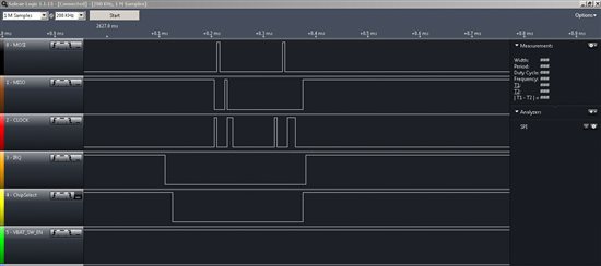

Dear Experts,
I'm working with MSP430G2553 on a launchpad and decided to buy CC3000EM wifi modules for experimenting the capabilities. However it turned out the connectors on CC3000EM is not compatible with my launchpad (my bad). So, I decided to make a breakout board with it to be able to connect it to launchpad via a prototype board. All went well, I mapped the power and SPI pins to the board. I followed the instructions here (http://processors.wiki.ti.com/index.php/CC3000_Basic_Wi-Fi_example_application_for_Launchpad) and downloaded the SDK from here (http://www.ti.com/litv/zip/swrc282), result is not very promising though.
I burn the code on MCU and reset the board, I'm using the virtual com port on the PC connected to launchpad via USB. Nothing happens... I checked the code for the proper pin connections, double-triple checked all the datasheets if I'm making any mistake and checked soldering of the breakout board if there's something wrong, everything seems to be correct, except the fact that I cannot communicate with CC3000EM, The string I'm supposed to see on terminal window "Example app: driver version...."doesn't appear.
I have the logical analyzer capture after a reset of the MSP, I'm running out of options. I'd appreciate any sort of help.
