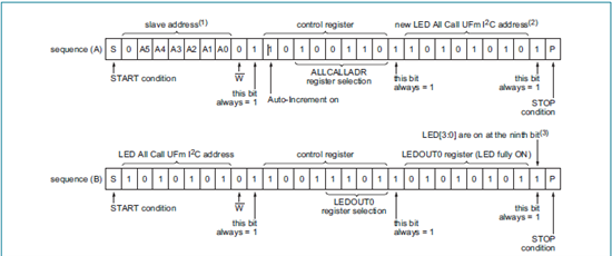

Ok so im using the PCU9656 Led Driver over I2C.  The adress is set via hardwear and it is not a reserved address when i had no ack at all i wrote a program to send the address to every address one by one to see what acked.  well after consulting the user manual again for the led driver i believe it doesnt ack in fact on some examples where you would expect it to pull low for an ack it points out that that bite is always a 1.  so heres my issue.  The msp430F5659 doesnt seem to allow me to keep sending when the address doesnt ack.  it sets UCTXNACK to 0 and UCNACKIFG to 1.  This also seems to drop whatever is in the tx buffer and send a stop condition over the bus.  I need to know what to do about this where i can send the address and bytes without caring if there is a nack after the address or the bytes...   Any help will be greatly appriceated.
  • Also here is a screen shot from the PCU9656 of an example. notice the 9th bite that should be pulled low for an ack or left high for a nack....  thats my problem is that this led driver seems to always leave it high and the MSP430 doesnt like that.
  • The UFm I2C receiver does not acknowledge the reception of data.
    While the USCI needs this acknowledge (which cannot be disabled) the USCI cannot be used to transmit UFm I2C.
    But on the other hand, the UFm I2C Slave is a receive only, which makes it easy to write a small piece of transmitter software, and can be outputted on any GPIO pin (no need for open-collector) without pull-up resistors, maybe in case of long bus wires some kind of termination may be necessary.
    Generate a START condition (CLK high and SDA to low) for each byte to transmit (including the first address byte), shift out the 8-data bits (MSB first) + one extra ‘1’ bit and generate 9 CLK pulses, no time delay necessary. When all bytes are transferred generate a STOP condition (CLK high and SDA to high).
  • Thank you thats exactly what i expected. My plane now is to change to port mapping by entering in a veriable to the port mapping function so i can use the same pins as is being used for other devices on my i2c bus.  i understand the i2c protocol very well and i know the sda only changes when the clk line is low that being said if you have any advice on bit banging and keeping two lines in sink for this feel free to let me know and thank you.

  • I would not share the UFm I2C with the classic bus, the electrical specifications are too different and why not having two (different) I2C busses.
    I wrote some code, try if this works;

  • Thank you this seems to work.  on my chip the SCL line runs about 75.3 kHz  and the start condition seems to bounce a little.  im not sure if for the LED driver im using if ill need to generate an extra clock pulse in between bytes or if they will need to squeeze together as one long data stream (including the nack bite of course) but ill find out soon.  if you find time   I wouldn't mind getting some details on your code.  i understand the majority of it but have a couple of questions so that i understand it well.
     In the MasterTransmit when you call TransmiteByte for the address i understand why and what your doing when you left shift it but not sure why theirs the and operator and FEh,
    In the TransmiteByte function can you explain the line where you set i equal to what it is and why the if statement is and'ed with 100h...   im assuming your accomplishing a check of the next bite one bite at a time but im just not seeing how it works exactly.
    again thank you very much and don't feel obligated to explain that stuff to me if you don't want too.
    Robert
  • After posting yesterday I changed the code today a little bit, it looks like you are using the latest version. I don’t have this device but put it on the G2xx EVM and test it with a scoop. Changed line: 45, 63 and 68, Added line: 54.
    Another case is the timing between sending a ‘0’ or a ‘1’ is a little bit different, there is a jump instruction after clearing the port bit, this will be not a problem at all but I hate such things. So I add after I2C_OUT |= USDA; 2 NOP’s and now its equal (until the optimizer change the order).
    Originally I did this to strip bit 7 which is not part of the address but while Value is a byte, the shift moves out bit 7. After the left shift bit 0 is the R/W bit and should be ‘0’, there are CPU’s you have a rotate op-code where you can shifts in a ‘1’ and C (if you don’t take care) can use the rotate in stat of the shift op-code, but I believe MSP430 doesn’t have this feature and not even a shift (I never invest much time to search for it). So this is just to be sure, and as long the address is a constant it doesn’t waist code.
    We have to send 8 data bits + 1 acknowledge bit, therefore I create a 9-bit word with bit 0 always ‘1’. Would we have this rotate op-code we can easily rotate-left out the bits to transmit, but instead we have to do it with the shift function. MSB goes first so bit-8 has to be compared and transmitted now, after this I shift the remaining bits (0-7) one place left so bit-7 becomes bit-8 and to be compared and transmitted next.

  • sorry but im not sure im fallowing exactly if this will work then good deal but i might need you to explain it to me.  just to be sure though LED number would be like the two bites in the array that control the LED...  honestly out of the two i only care about the most significant cause it can be controlled and my over all function takes care of brightness which is another array that i have no problem with.  so for the array i have to send to the driver is
    unsigned char LedState[7] =
    0x9D,    // this being the address of the register and an auto increment flag so this never changes.
    0xAA,  // this bite has 4 led's it controlls ever two zeros is one LED so all 4 leds are on and controlled by pwm
    0xAA,//  beacuse they are 10   so if i want to turn an led on or off i need to change say the first 1 in 10101010 to
    0xAA, // 00101010 to turn that one off and so on and all of this is just one byte all the bytes under 0x9D control
    0xAA, //4 led's
    0xAA,
    0xAA
    so if i wanted to turn off 2 led's specifically a certen two i may have to send
    0x9D,
    0x2A,  //  one bite was changed for an led the first led
    0xA2,//  then another one bite was changed for the next led i wanted to change out of the 4 this byte represents
    0xAA,
    0xAA,
    0xAA,
    0xAA
    so i have a function already written that i enter the led number, color, pwm value, and a 1 or 0 for on and off
    inside the function there is a switch statement and if statements so if its led 1 and its to be turned on inside of that if statement i need a function to say change that one bit in that one byte in the array that i posted earlyer....   i would of just had it give the value you would expect if that led would be turned on but it would turn on or off other led's to change the whole byte.  in my global array ledstate
    ill test out your function out in a few min but may need some things explained like is InArray supposed to represent my array? and if so LEDno would i think be the byte that needs to get changed but i dont think it points out the bite to actually change.
    i apologize if im frustrating i tend to understand a lot in c programming and can normally get anything to work just id hate to have to do it the hard way and do a crazy amount more if statements just to check the bytes and change the whole value when there are ways to just change one bite at a time.
    i really do appreciate you help and patience.
  • ok i apologize i was given a function that didnt work for what i wanted and now i found my answer im sure yours worked fine but really all i needed was
    LedState[x] |= (1 << n);
    LedState[x] &= ~(1 << n);
    x being the byte in my array and n being the bit i needed to change. i haven't done much with individual bits changed this way and was led to believer it would take a special function. shows how i still don't have a ton of experience... with these in my function i will be able to accomplish my goal and everything should work fine as iv tested this on code composer at home and it should do exactly what i want i do thank you for your help.
