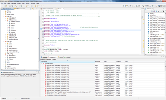

Hello everybody,
i'd need some help with a the USB Interface of the MSP430F6636
Goal is to achieve a MSC + CDC.
After reading the Programmer's guide, successfully tryied both MSC SD Card & Simple CDC LED example on my custom board.
i just tried to merge both applications, using the descriptor tool as help
SO here is what I've done.
Created a new project
- Copied USB_API Folder from the devpack
- Copied CDC's USB_Config folder, deleted the files inside, replaced with the descriptor's output
- Copied the CDC's USB_App folder
- Added FatFs folder, msc.c & .h into the USB_App folder
- Copied CDC's hal.c & .h main.c & system_pre_init.c into the project
- Added these Include lines from the MSC example into the main.
  #include "USB_API/USB_MSC_API/UsbMscScsi.h"
  #include "USB_API/USB_MSC_API/UsbMsc.h"
  #include "USB_API/USB_MSC_API/UsbMscStateMachine.h"
  #include "USB_app/msc.h"  // FatFs #includes
Now when i build the project, i become these errors (see Pic)
If needed I'll upload the complete list.
I think all starts here #145 ....
Any ideas ?
