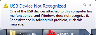

  • After we added a 1K resistor between PUR and DP we got the windows machine to recognize that there is a device plugged in, but we keep getting this message:
    So windows is enumerating the device, but not recognizing it as a HID.

    Don't understand why Is so hard to check first design of working boards, and than based on this make your own.
    Resistor between PUR / DP is 1k4 and you don't need to make any USB BSL entry sequence, because blank / erased / virgin MSP430 USB device will enter to USB BSL mode automatically, after plugging USB cable to PC. Running MSP430 USB with VCC different than 3.3V (or on battery) is not problem at all, but voltage on PUR pin must be (close to) 3.3V all the time (and for this can be used internal 3.3V reg).
