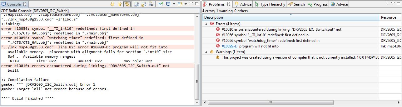

I am having a problem using the watchdog timer ISR on the G2553 launchpad. I want to use switch2 to toggle the LEDs if it is pressed/released. I am using the watchdog timer as a delay for the switch debounce. Port 1 is being used for the button interrupt and the WDT is being used as the delay to reenable the button interrupt.
WHen I try to compile, it says that it the program will not fit in it. I attached a screenshot of the console.

Using CCS Version 5.5.0.00077, GCC Compiler IT v4.0.0
  • The error messages are indicating that the linker has found two definitions of WDT_VECTOR and PORT1_VECTOR. You have one of each defined in your .c file, but are also linking with CTS_HAL.obj which contains its own definitions of those ISRs.
    Is your project building another file (probably called CTS_HAL.c), or are you linking in an external library? Either way you'll have to resolve the conflict with that object file to be able to build successfully.
  • Hello David,
    The 1st two errors need to be cleaned up first.  It looks like you are re-defining variables already defined in the included libraries.  WDT interrupt vector is defined in CTS_HAL.c file required for captouch when the pre-compiler variable WDT_GATE is defined.  This might mean that you selected a definition that uses a WDT.  In this case the RO_PINOSC_TA0_WDTp has been selected.
    If you are trying to perform haptics, then haptics requires two timers and captouch requires two timers and there are only three timers on the G2553 if you count the watch dog.  You can try sharing WDT between the haptics, captouch and your application by setting the WDT to a 1 or 2ms tick rate and then using multiples for the haptics, the captouch and your application.
    Arthi
  • thanks, I didn't look at it closely enough. Thanks for the help. I didn't fully understand the captouch software and how things were linked together with the haptics portion.
