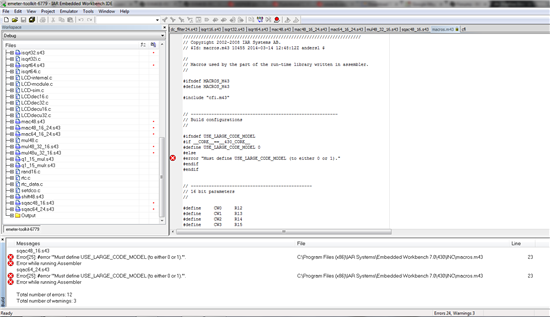

I'm trying to Rebuild All emeter-toolkit-6779.ewp from slaa577e.
I am using IAR Workbench Version 6.10.1
I have 12 errors all associated with a file named macros.m43 Line 23.
I expect that a clean version of this project with no edits should build cleanly.
The attachment should show the problem.
Bart

  • Bart,
    I was able to get the project to compile on the new IAR. It seems that the translation left out a definition in the project properties for the USE_LARGE_CODE_MODEL symbol.
    If you navigate from the right click -> Options window to Assembler -> Preprocessor, you can add USE_LARGE_CODE_MODEL to the list of defined symbols. Also ensure that you are using the large code model in the General Options -> Target -> Code Model option.
    This should get the program to compile fully without warning/error.
    Let me know if this works for you as well.
