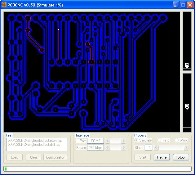

    5 years ago, I was working on my own CNC solution for PCB's with 2 tolls (mill / drill) on Z, but it stay unfinished. Hope it will be finished one day. It is based on MSP430F550X with USB connection to PC.
