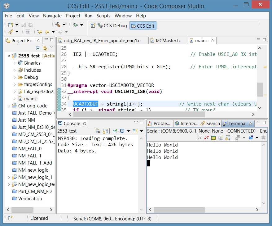

    It works for me on an MSP-EXP430G2 launchpad with an msp430g2553. I get the full message "Hello World" in the terminal window.

  • HI Corini,
    My apologies, your earlier code was absolutely fine, I just over looked the idea that once UCA0TXBUF is dumped UCA0TXIFG is cleared automatically. I have ran u r cde and it did run well so sorry for mis leading you for a while. I should have tried your code before commenting any way.
    Once you have loaded your code.
    in CCS-->

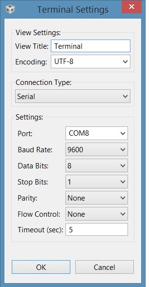

    go to View>>other>>Terminal>>terminal.
     a termnal concol opensup, just like Problems and search .
    now clcik on that hover over that yellow notepad like button (settings) and click.
    My Launchpad is connected to com8 (automatically detected) so should yours.
    After loading the code. Open the terminal make necessary settings and click on conncect button.
    If you do not see hello worlld. Press and hold reset button for 10 seconds and then release. Bingo.
    Apologies agin.
    cheers.

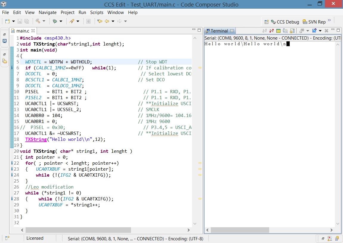

  • Hello sri,
    I want to thank you, the code works. You made me a beautiful picture in front of the professor.
    But now I have a new problem, I built the following program compiles without errors, but I do not write hello world, I do not understand why, though I copied the function TXString on CCS; you can give it a try, thank you.
    #include <msp430.h>
    void TXString(char*string1,int lenght);
    volatile unsigned int i=0;
    int main(void)
      WDTCTL = WDTPW + WDTHOLD;                 // Stop WDT

      TXString("Hello world\\n",12);
    void TXString( char* string1, int lenght )
      int pointer=0;
      for( pointer = 0; pointer < lenght; pointer++)
    	  volatile int i;
    	  UCA0TXBUF = string1[pointer];
    	  while (!(IFG2 & UCA0TXIFG));
  • You're enabling the USCI TX interrupt and setting GIE. When UCA0TXIFG gets set the MCU will try to jump to the USCIAB0TX_VECTOR ISR, but it doesn't exist.
  • then it should work if I delete this line?
      __bis_SR_register(LPM0_bits + GIE);
      int pointer=0;
    	  volatile int i;
    No, that would be a bad idea. If you delete that whole line the MCU won't enter low power mode, meaning that there's nothing to stop execution continuing past the end of main().
    You still need to enter low power mode, just without setting GIE or UCA0TXIE.

    #endif
    chers
  • Hi Sri,
    Some little corrections;
    sri-sri said:
    #ifndef test1 TXString("Hello world\r\n",12); #endif
    The Return (\r) can be omitted will be automatically added by HyperTerminal, otherwise the length needs to be 13.
      int pointer=0;
      for(; pointer < lenght; pointer++)
    //      volatile int i;
      while (*string1 != 0)
    	  UCA0TXBUF = *string1++;
    The volatile int i; can removed.
    In the for() you don’t need to clear pointer while it’s already done.
    Another way to output a variable length of string is the while example.
  • Cool Leo,
    Thank you so much.
    Cheers! :)
    { int pointer = 0;
      for( ; pointer < lenght; pointer++)
      {   UCA0TXBUF = string1[pointer];
      //Leo modification
      {    while (!(IFG2 & UCA0TXIFG));
