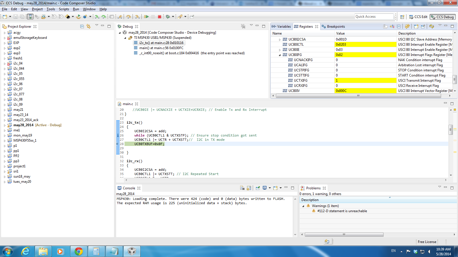

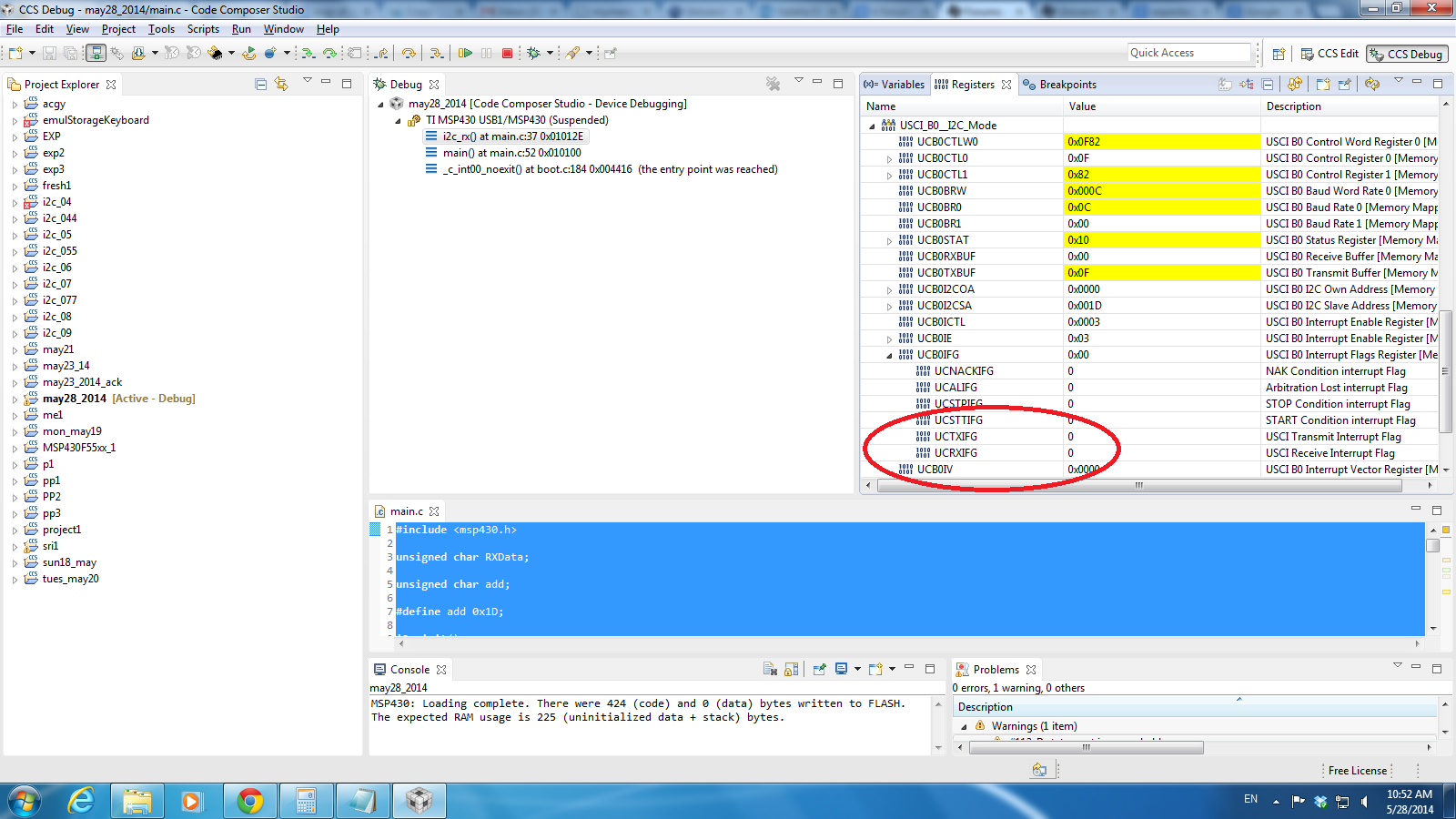

  • In my previous post, I have included the original source code. But when I am using MSP430F5529, I am using
    #include "msp430f5529.h". Then should I conclude that those registers which are showing undefined in the compiler are actually not a part of MSP430F5529 but a part of MSP430G2553?
    Saleha Khatun

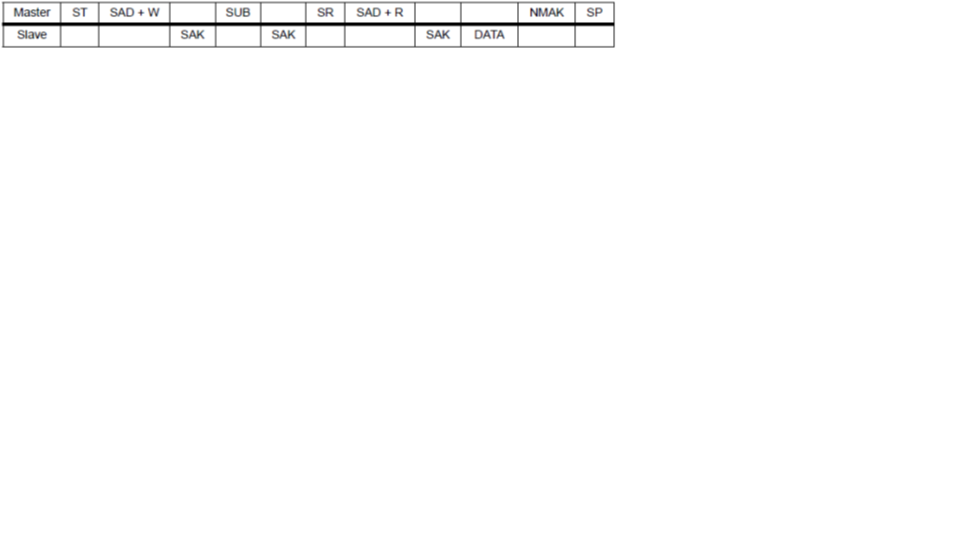

    2. I am working with a sensor and try to read some data using MSP430F5529. In the sensor datasheet, it is given that the reading protocol is in the attachment.
    Suppose a sensor address is 1D. While reading from that sensor, the protocol says that from the master side, first one has to send the start signal, modified sensor address to write and so on. Now the modified address would be 3A to write. My question is while initializing I2c ,shuld i load the UCB0I2CSA with actual address and in ISR case 12, should I send the modified address?
  • A simple answer would be Modified address.
    But, What is the modified address?

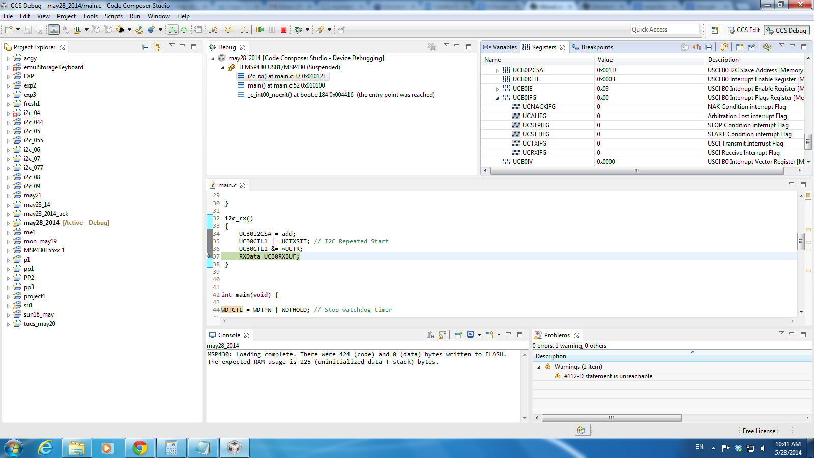

    See this way.
    1.set up a break point right after
                      UCB0CTL1 |=  UCTR + UCTXSTT;
       in I2C Write function.
    2.set up a brak poit after
                      UCB0CTL &= ~UCTR;
    in I2C read function.
    after the execution halted at either of this this lines. Expand Special function register from registers view and further expand IFG2 register.
    now hit F6, you will see either of UCB0TXIFG or UCB0RXIFG being set. Mean you are transmitting/Receiving.
    point 1. You will see UCB0TXIFG being set for I2c WRITE FUNCTION. Which explains you how I2C machine works without changing / modifying the slave address.

    just to check the change of the flag of TX and RX, I have written the below code. For my case,see the screenshot of Special function register:
    and the screenshot of the flag register that I have used to check:
    My code to check the flag only:

    After Tx function:bit changed:
    after rx function: bit not changed:
    Please explain....:)
