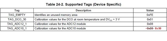

    Does the following from the MSP430G2453 datasheet answer your question?

    slau144j page 581, chapter TLV structure
    http://www.ti.com/lit/ug/slau144j/slau144j.pdf
    at the begin:
    The Tag-Length-Value (TLV) structure is used in selected
    MSP430x2xx devices to provide device-specific information
    in the device's flash memory SegmentA,
    such as calibration data.
    Chester Gillon paste you infrormation from the MSP430G2453 datashet,
    b.r.
    Lukasz

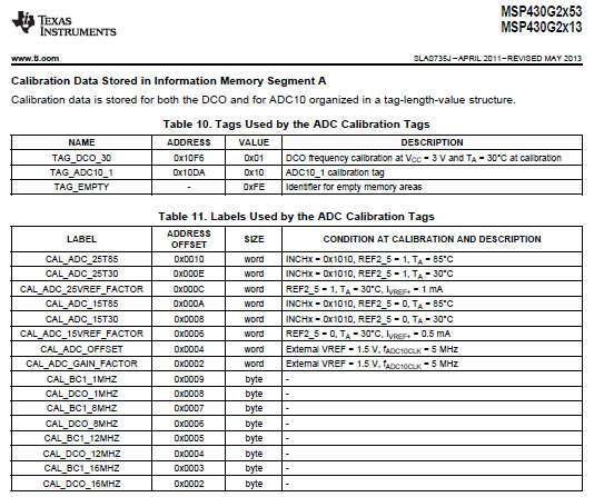

    2)      Dear Chester Gallon, the information from my original post is directly from the Table 10, thus my question is still not answered.  I will repeat my original question again just for the sake of clarity:
    I have identified the DCO constants address range in Seg-A, but I am not sure of any of the information stored in this segment of memory other than the listing for the ADC10_1 calibration tag (0x10da).  For example, there is die info stored, what address range is this info stored in?

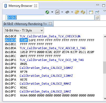

    To avoid confusion, can you post a memory dump of the Info Segment A from your device. This is an example taken from a MSP430G2553 in the CCSv6 debugger:
    By comparing the contents of the memory dump against Tables 10 and 11 in the MSP430G2x53 datasheet SLAS735J and the TLV Structure section in the MSP430x2xx Family User's Guide SLAU144J all the non-erased bytes are accounted for. The unused bytes in Information Segment A are:
    - 22 bytes from 0x10C4 to 0x10D9
    - 8 bytes from 0x10EE to 0x10F5
    If the unused bytes in Information Segment A are programmed, then the checksum in the first two bytes of Segment A should be re-calculated, so that any software check checks the integrity of the checksum of the TLV Structures doesn't report a failure.

    The version of CCS used to provide the memory dump doesn't matter. The reason I suggested a memory dump was to clarify exactly what was in the Info-A segment of your device.

  • Hi Chester,
    Forgive my ignorance,  I can not find a "Memory Browser" in CCSv4.2.
    Your screen capture is awesome, does your version of CCS actually show the nature of the SegA contents in blue font?
    I am now upgrading to CCSv5.5, will v5.5 show this info if v4.2 does not?
    FYI-1, v4.2 has an error that I have lived with, VIEW > MEMORY the address input field is a little box, I can not see the address, but I can still put the address in blind :) to get to a location during debugging.  As you see, I have been waiting for things to settle down.  CCS is an awesome product and getting better each day, I just want others to find the problems and I benefit :)
    Yes, that was automatically done by CCSv6

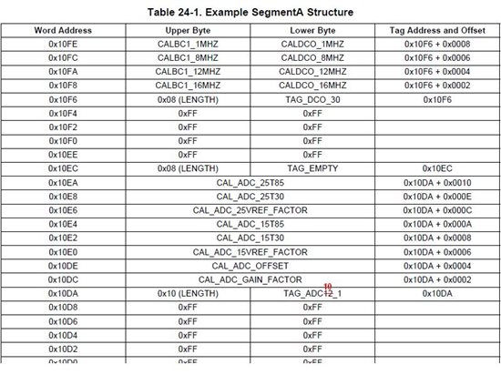

    First a disclaimer: I am just a hobbyist, I am not an Engineer, and I am not affiliated with TI. What I said below are just my understanding of what I read from TI documents that are public.
    Currently there are three silicon revisions of MSP430G2453. As far as the TLV structure in InfoA is concerned, all three silicon revisions are supposed to be the same. This is quite adequately described in Chapter 24 of MSP430x2xx Family User's Guide (SLAU144?.pdf where ? is the version #)
    I found in SLAU144j.pdf (the current version) that you need to make the following two changes marked in red to apply to MSP430G2453.
    ... My plan is to use InfoA as an occasional write of information that would be under controlled conditions, for the majority of the life of the product InfoA is locked and safe from erasure....
    I think you can, if you want to, ignore and erase this entire TLV without any harm.
    You also have the option to store your own data inside the two TAG_EMPTY slots.  But you need to update the XOR checksum too in order the preserve the integrity of the TLV.
