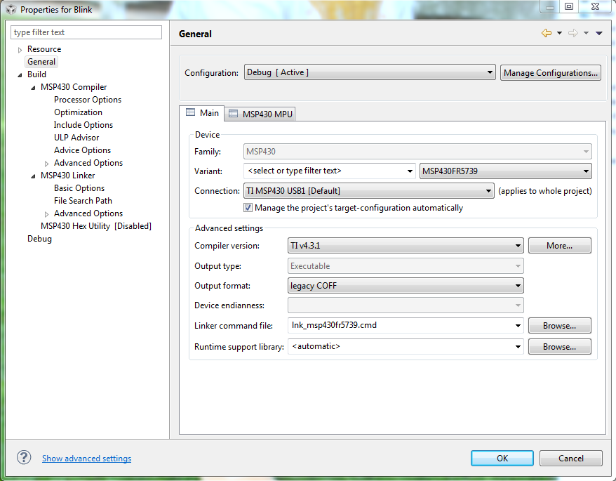

  • Hi Yannick,
    The output format can be selected using the project property window. To open the project property window, right click in the project and select "Properties". Select "General" menu and you will be able to switch from eabi (ELF) format to "legacy COFF".
    Ivan
  • Hi Ivan,

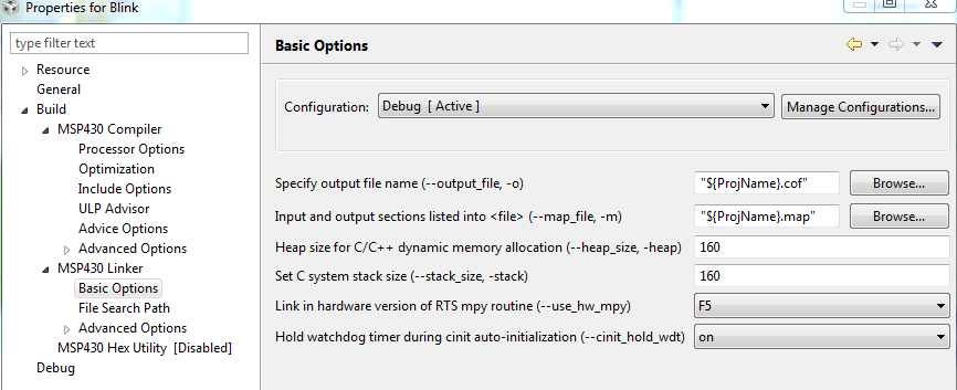

    thanks for the response. I´m find the solution this night. To build the COFF file we need 2 steps.
    1_ Select the output format:
    2_ change (specify output file) the Format ending ( MSP430 Linker -> Basic Options -> "${ProjName}.out") , change with ("${ProjName}.cof").
