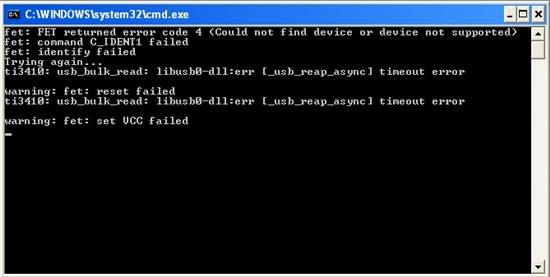

I'm trying to load the firmware on a MSP430F2112 micro using the MSP430 USB-Debug-Interface. Board is inside a test adapter where 12-conductor cable ( I assured that it not exceed 8 inches) acceded test points in the board  through needles to make the connection. I always receive error when I try to execute the mspdebug command:
mspdebug -q uif -j -s

That's error I receive
I supposse it is a HW problem. When I supply the board without test adapter and plug the 14-conductor cable in the connector from board (not in test points) I receive no error.  Mybe signal synchronisation because of  disturbance in test adapter?
i would also like to know wht's the HW meaning of these error messages.

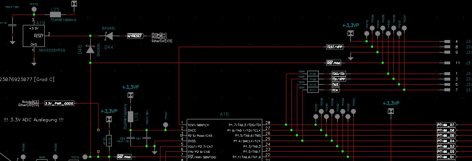

    Roberto Romano said:
     How reset line is connected? Are capacitor on reset?
    There is no capacitor on reset. Only a needle is connected with the pin. Could that be the problem? Without the test adapter, reset is not conected with any needle and taht's the case where I can programm the micro.
    What is the meaning of the error message?
    Thank you in advance

  • Jesus Zafra said:
    ... There is no capacitor on reset. Only a needle is connected with the pin. Could that be the problem? ...
    I do not think that is a big problem. Only that it may be sensitive to RF noise.
    Jesus Zafra said:
    ... on reset. Only a needle is connected with the pin ... Without the test adapter, reset is not conected with any needle ...
    Do you mean that the RST pin of the chip is connected to a needle, but that needle is not connected to the JTAG Tool? If so, that is the real problem. There should be a total of 8 connections between the chip and the JTAG Tool. Vcc, Gnd, RST, TEST, and the 4 wire JTAG signals.

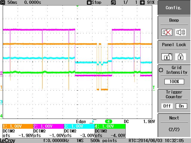

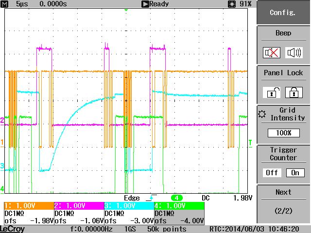

    No, in the two cases there are always 8 connections.
    I measured some of the JTAG signals with the oscilloscope.
    Channel 1: TCK
    Channel 2: TMS
    Channel 3: TDO/TDI
    CHannel 4: TDI/VPP
    Taht's the case where the firmware is programed without error:
    Taht's the case where the same board is inside a test adapter and I am not be able to program the firmware and error message appears
    You can see here that the Frequence of the clock is lower. Maybe too much noise in adapter affects the clock signal?
    Jesus
  •  Channel 3 appear as if it was disconnected. Is completely different from behave when working.
     Is this pin in metal contact if measured with a tester?
