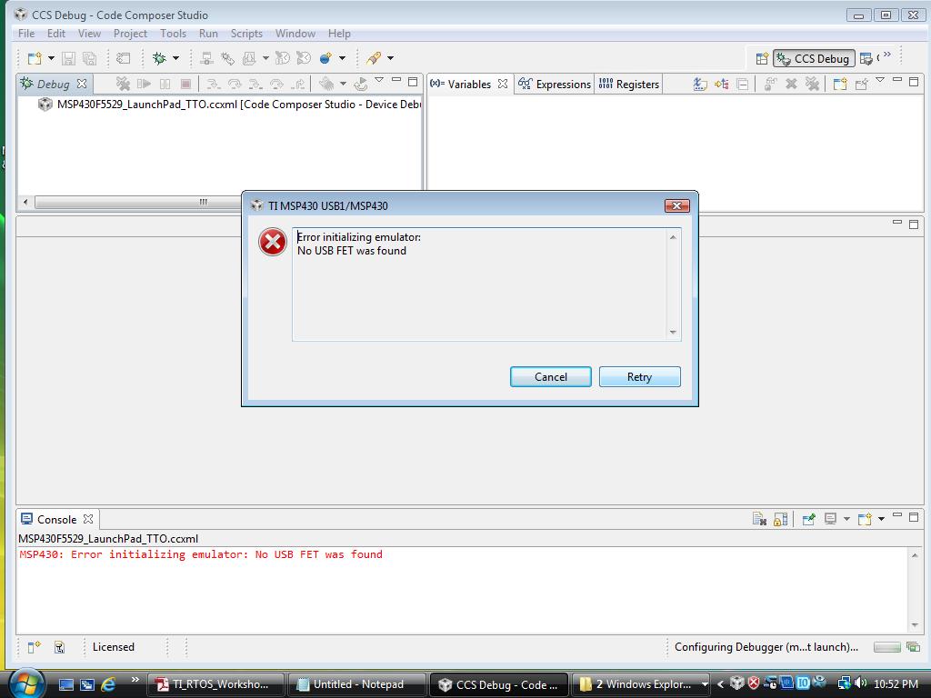

Dear Sir:
     I am new to the MSP430f5529 product line.  I purchased the Launchpad Evaluation Kit.
     This is the problem.   I followed Lab 1 of the TI RTOS Workshop.   This lab verifies that the Code Composer (CC) 5.3 software has been installed correctly.   The lab only seeks for the operator to import a user defined target configuration and launch the target configuration.
      When I launch the target configuration this error message is returned:
MSP430: Error initializing emulator: No USB FET was found
      I know that for some unknown reason the TI software install failed.
      I am enclosing a copy of a document that may tell you where the source of the error lies.

        I hope you will be able to click on this document and read the installation error messages.
        This error document is my best guess as to the source of the error message that I saw in the screenshot.
        I am using the Vista O/S and I do not know why the installation failed (if this is the source of the problem).
        I was hoping that you could reply with some feedback and what I should do to remedy my problem.  I believe that it is possible that  a correct sequence of software installation may have to be followed.   If  this is the case, I need to know the correct uninstallation method and the correct software installation sequence to follow.

  • Hi Michael,
    CCSv5.3 was released long before the MSP-EXP430F5529LP Launchpad, so I suspect there may not be support for the emulator on the F5529 launchpad in that version. Could you please try downloading the latest version of CCS (6.0) and see if you are able to program the device? If you are reluctant to move to CCSv6, CCSv5.5 should at least support the 5529 launchpad.

  • Dear Katie;
    To answer your question:
    Where did the log file come from - was this a log generated simply when you installed CCSv5.3?
    I found the log file in this TI software created directory:
    C:\ti\fetdrivers\install_logs
    I can't tell you much more than this because the user "start up software" directions for these kits leave it up to the user to find most of the appropriate software and educational materials.   When we open the box that contains the kit the flyers lead us to a webpage and after that the trail goes cold because the webpage does not explicitly point the reader to a complete download list of software that is matched to the specific hardware.
    I hope you find this information helpful.   I am going to download and install CC6 and tell you the outcome.
  • Dear Katie;
         Thank you for your feedback.
          I installed CC6 and there was no error message.   Problem solved.
          Again, I would like to thank you for your help.   Good Call.
