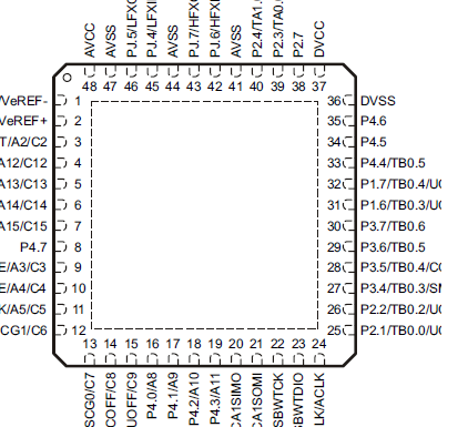

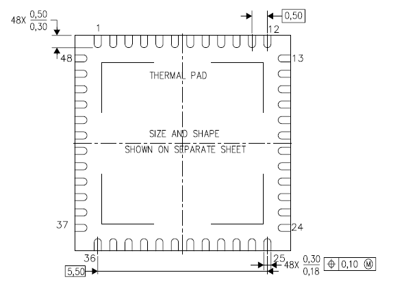

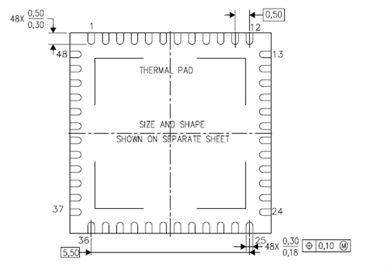

  Would you please provide the correct MECHANICAL DATA of Pack form?
  * Regarding to FR59xx datasheet, there are some differences in the Pin Diagram and PKG data in MECHANICAL DATA.

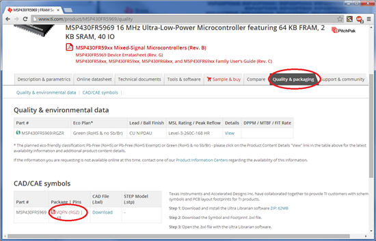

    [Question.2]
    If you are looking for the mechanical measurement of the packaging, this can be found in the product web page, "Quality & packaging" section -> "CAD/CAE symbols"

    [Question.2]
    [Kaka]
    In my understanding, there is difference of Package layout.  According to the pin diagram and EVM, the package is not square. i.e. the corner is blunt tip.

  • Kaka,
    since I am not the owner of the document, I can't really answer why the pin diagram is illustrated with blunt tip corners. However I believe you should refer to the mechanical data for the real packaging shape and size. Will try to check this internally.

  • Hi Leo,
    Thank you for your response.
    If you can check the package size in internally, please let me know.
    When I checked the package with Lanchpad of FR59xx, the package is square.
    Kaka

  • Queries like that take some time to get answered internally. Especially if there's Pentecost (which is a long celebration weekend in Germany, where Leo is located, and most people take a long vacation weekend.
    However, I'd say, the drawing for the pinout is rather symbolic, and the one in the package drawings is the right one (that's why the package types are listed). Often, there are multiple packages available with the same pin count and layout, and it makes no sense to list the pinout multiple times with just slight differences in the package outline.
    If you are in doubt, order a sample and you'll know for sure. :)
  • Kato,
    I think JMG was right, the illustration for the pinout is just symbolic, and for the real package form and measurement, you need to refer to the mechanical packaging section.
