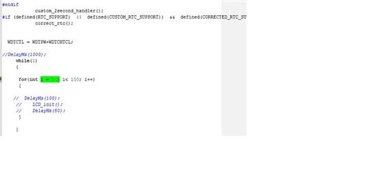

  • Guys!
    I noticed that the "kick" command keep the WDT disabled! In order to put him back I used the following command.
    IE1 |= WDTIE;
    but had no success! (still no reset!)
    And nor th efollowing.
    WDCTL = (WDTCTL & 0xFF) | WDTPW | WDTCNTL;
    So, how can I make WD alive back?
  • Why are you messing with IE1?, are you not getting what a watchdog does?
    WDT in watchdog-mode does not generate a IRQ, it does not jump to some imaginary IRQ location to reset the mcu.
    When the counter reach 32768 a hardware switch will reset the MCU.
    You START and KICK the WDT this (and only this): WDCTL = WDTPW+WDTCNTCL
    And you stop the watchdog-mode with this (and only this): WDCTL = WDTPW+WDTHOLD
    In Watchdog mode, your code can NOT go longer than 32mS without Kicking the dog. (1mhz smclk)
    Turning WDT on and off when code routine is slower will lessen its effect as what can hang the mcu could probably happen there.
    If you Div (/2 /4 /8) the smclk you get more time and the same with aclk divided by /2 /4 /8
    Using ACLK clock for WDT gives you 1-8second WDCTL = WDTPW+WDTCNTCL+WDTSSEL
    if you have 32k crystal.
    >I was told that I need to re-set it back just in case if the program crashes
    What is a re-set?, turning it off? if the program crashes a wdt will reset the mcu
    Your code don't have to turn-it off as long the boot-up sequence don't take longer than 32ms
    If it does and you don't feel kicking the dog there, it's common to put WDCTL = WDTPW+WDTHOLD in the first lines of code as WDTCNTCL is the msp430's default state after a reset.

    Ok, Let me explain you what I would like to do. I have a Show() Function that shows the Kilo Watt hours Register. In the code they set the WDT to WDTPW+WDTCNTCL+WDTSSEL that counts 1 sec. and during this I can see what display function produces. However, I would like the WDT to be stopped and if I put the following infinit loop right after the Show(), instead of getting frozen, it start over again.
    Show()
    while(1)
    for(int i = 0 ; i <= 100 ; i++)
    Yes, they have used this to clear the counter and set it to the a certain time.
    And this stops counting but it goes to that infinite loop and gets stuck!
    Any idea?

  • Tony!
    I believe that we are on the same page but when I stop the watchdog meaning that I ask it not to bite and then I can do the regular stuff in my loop, but thereafter I would like him to bite and keep biting ... so not WDTCTL = WDTPW+ WDTHOLD
    nor WDTCTL = WDTPW + WDTCNTCL can set it back. Do you know what I mean?
    As you said I may need to play with memory cells to ask him to bite!

  • Tony!
    Question for you please! Your method works in a small sample code but when it comes to apply in my huge project does not work! There is something set wrong that makes the display frozen!
    In the body of the code it stops the WDT, after display it starts the WDT but it still goes to the infinite loop and gets stuck there!
    I need to put some break point and see what the heck is going on!
  • Oh! I found out something! Actually it doe snot go to the infinite loop it updates the display but it does not initialize the new amount and it just shows 0 0 0 ....
    Seems I screwed up the other .c files!
  • Well, actually I am re-stating that it DOES go to the infinite loop! So, this shows that WDT is still disabled! :(

    My loop is short as follows.
         while(1)
          for(int i = 0 ; i< 100; i++)
          DelayMs(100);
             LCD_init();
             DelayMs(50);
    This deletes the display.

    I just set it right before the infinite and also tested with delay as well! Non worked!

  • That is so weird!
    It still goes to the loop! :(
  • Goes to what loop?
    How is that Loop started?, is it a time based IRQ?
    Probably is, as delay() in C is whatever C wants it to be and you have no control.
    And a empty While(1){} may be deleted by C, so put something there.
    before the WDCTL line add this: _BIC_SR(GIE)
  • Infinite loop! The one with delay as you pointed at!
    They have used timers and delay as well, yes.
    oh I see let me try then!
    Thanks!
  • When I add    _BIC_SR(GIE) ; before WDT, it does not even show the infinite loop! It kills everything!

  • Here is working nicely!
    oid main(void)
     WDTCTL = WDTPW +WDTHOLD;                 // Do not rest! --- Disable the WDT
      // WDTCTL =   WDT_ARST_16 ;
    while(1)
          //*** LCD Setups
          P7DIR = 0x00; // Redundant
          P8OUT = 0;    // Before set DIR
          P8DIR = 0x07; //P8.2=>EN, P8.1=>RW, P8.0=>RS
          DelayMs(100);
          LCD_init();
          DelayMs(50);
    for(int j=0; j<=7;j++)
        LCD_cmd(0x80);
      LCD_dat(esi[j]);
      DelayMs(1000);
      //******    reset here! --- Enable the WDt
    WDTCTL =   WDT_ARST_1_9  ;
     // WDTCTL = WDTPW+WDTHOLD;
    //DelayMs(1000);
      while(1)
          for (int i = 0 ; i <= 100; i++)
          DelayMs(100);
          LCD_init();
          DelayMs(50);
        LCD_cmd(0x80);
      LCD_dat(0xFF);
    stop and before while(1) starts!

    Still gets stuck in the while!
               update_display();
              if (wdt_flg == 1)
                 WDTCTL = WDTPW +WDTCNTCL+WDTSSEL+WDTIS0;
              wdt_flg *= 0;
                while(1)
                  LCD_cmd(0x80);
                  LCD_dat(0xFF);
