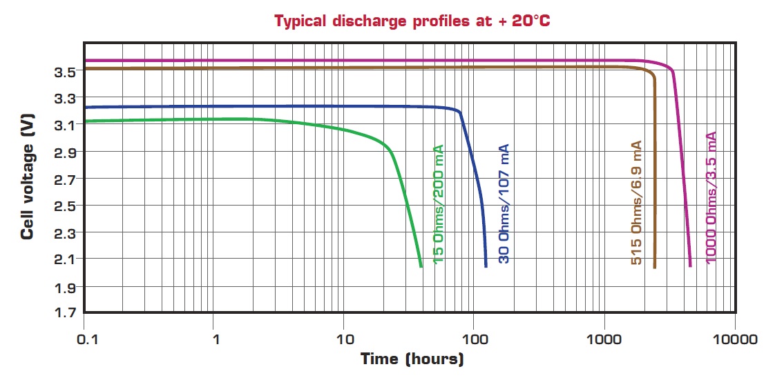

I am new at battery technologies and I need some guidance. I will try to explain my problem.
I am designing a battery powered device. I will use Non-Rechargeable battery such as 19000mAh 3.6V Primary lithium battery in my design. I use TI MSP430F247 microcontroller which has 12-bit SAR ADC.
I have to measure battery before starting to drive some equipment such as GSM Module in my circuit. Because if the battery capacity is not enough for driving the modules I should not start the modules and I should start the special process. But my problem is that I cannot understand battery capacity by measuring voltage of the battery using MSP430F247's ADC. Because the battery voltage level is always the same until the battery is exhausted. You can see this state on the following diagram which is the battery discharge profile.

    This is a general problem with batteries. You can't really measure "remaining life" just from voltage because of the long flat plateau and then the steep cliff.
    Without using a gas gauge IC (which measures energy draw) the best you can do is pick a voltage cutoff point at which it isn't enough for your add-on module.
  • If the range of your load and the temperature is relatively narrow, it can sometimes make sense to simply measure the voltage to get an idea of the relative state of charge.  This might work in some cases for rechargeable lithium-ion batteries, but for primary lithium batteries (one-time use) the voltage profile is so extremely flat that this usually isn't possible.
    For those cases, the only currently available solution is to count the coulombs as they leave the battery by integrating the voltage across a sense resistor.  We call ICs that just do coulomb counting battery monitors and we have many older ICs that can do that for you, but the latest and greatest option for doing that is to use one of our gauges and ignore the gauging function (which is tailored for rechargeable batteries) to just use the coulomb counting register.  The app notes SLUA347 and SLUA367 explain how to achieve this.
