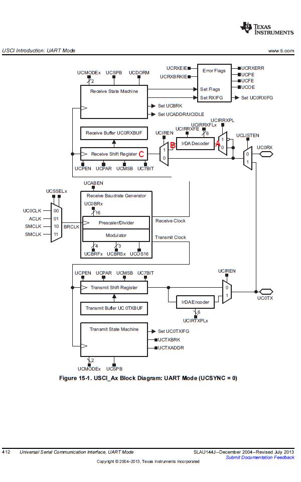

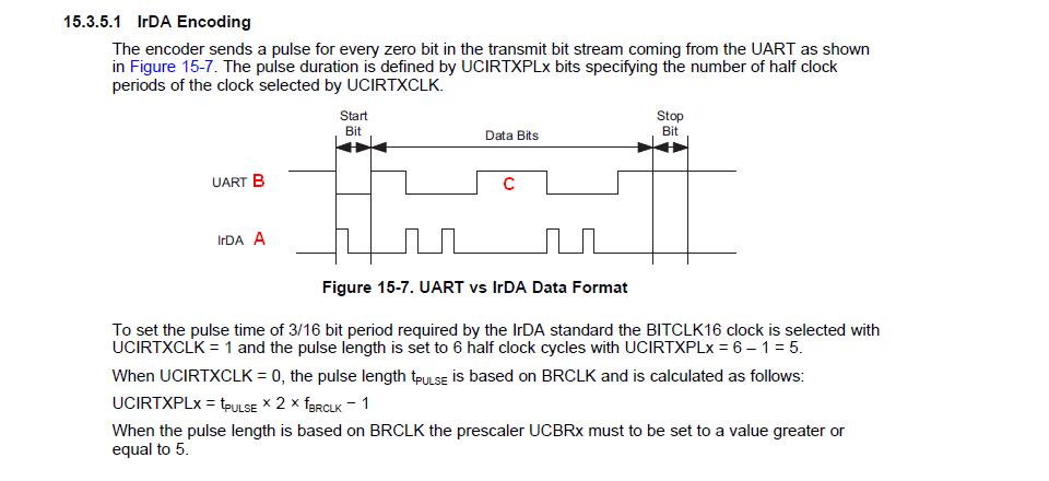

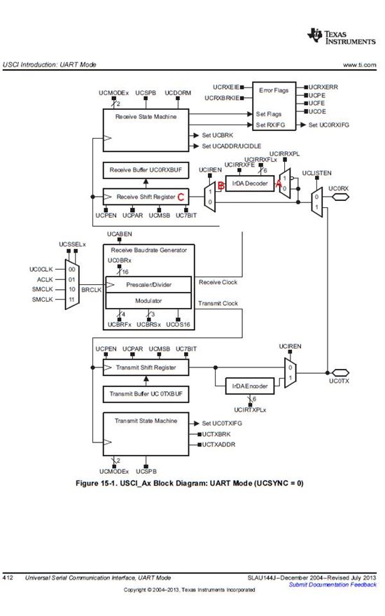

  • (A) This signal is a pulse.
    (B) This signal is NRZ.
    (C) “Majority vote” is performed here (with or without IrDA Decoding enabled).
  • Edit: ok, I see now, the IRDA decoder is in front of the Receive Shift Register. Marked by you with 'B' this means that NRZ is going into the shift register and that the majority votes only come in play on the NRZ signal and not on the pulses!
    That way there should be no problem pulses being 'too short (only too late/too early)'. That also means that the IRDA decoder is smart enough to make the signal NRZ at the appropriate time.
    Maybe it even operates on its own behalf (any pulse long enough will result in a '0' in the NRZ signal for the full length of a bit)? Or is the latter not true? Because that would also implicate that any late or early pulse would not have any impact as the voting is only done half a bitlength later than the pulse had been received and the NRZ signal is already there for quite some time. This does not seem to be as our off-clock causes reception problems.

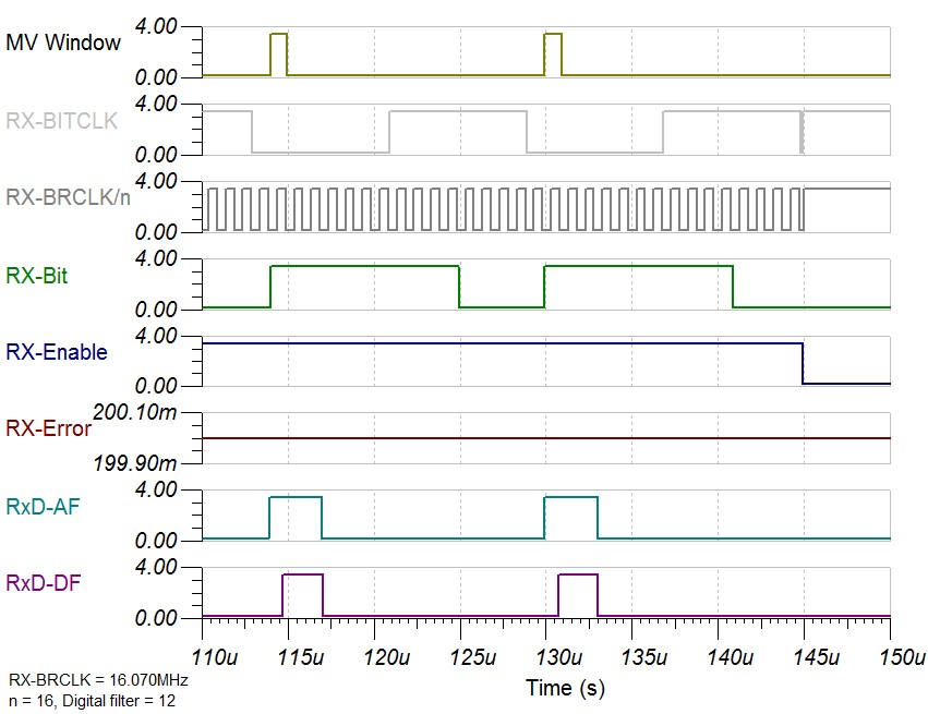

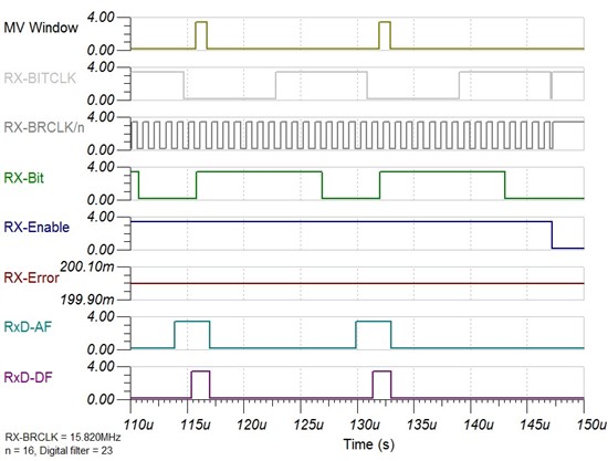

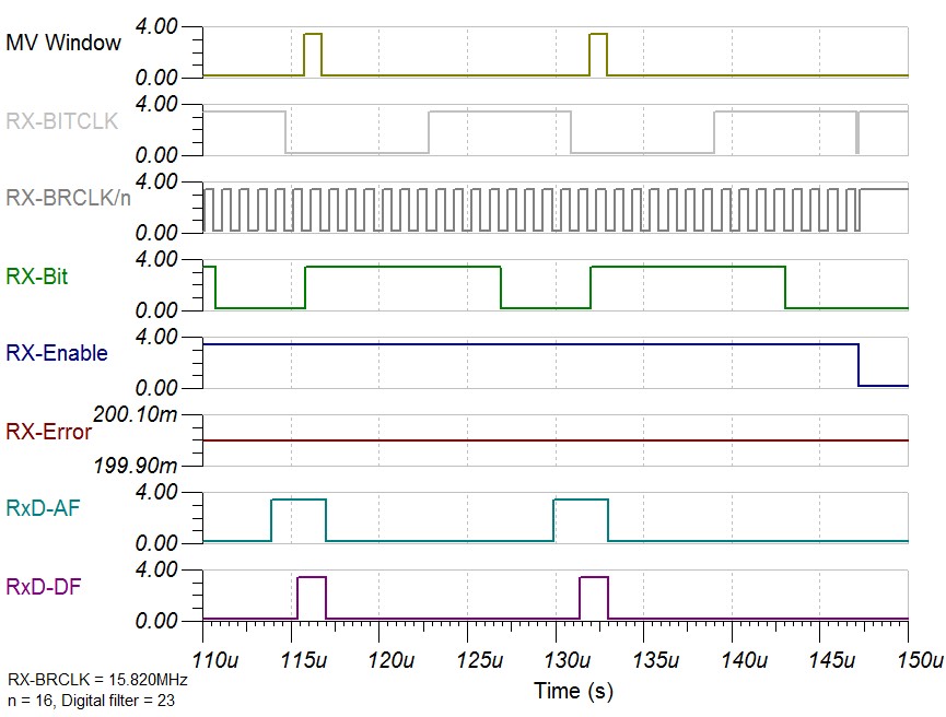

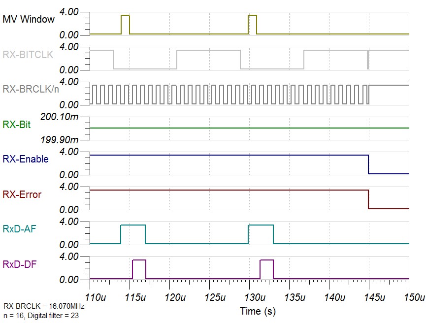

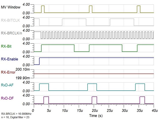

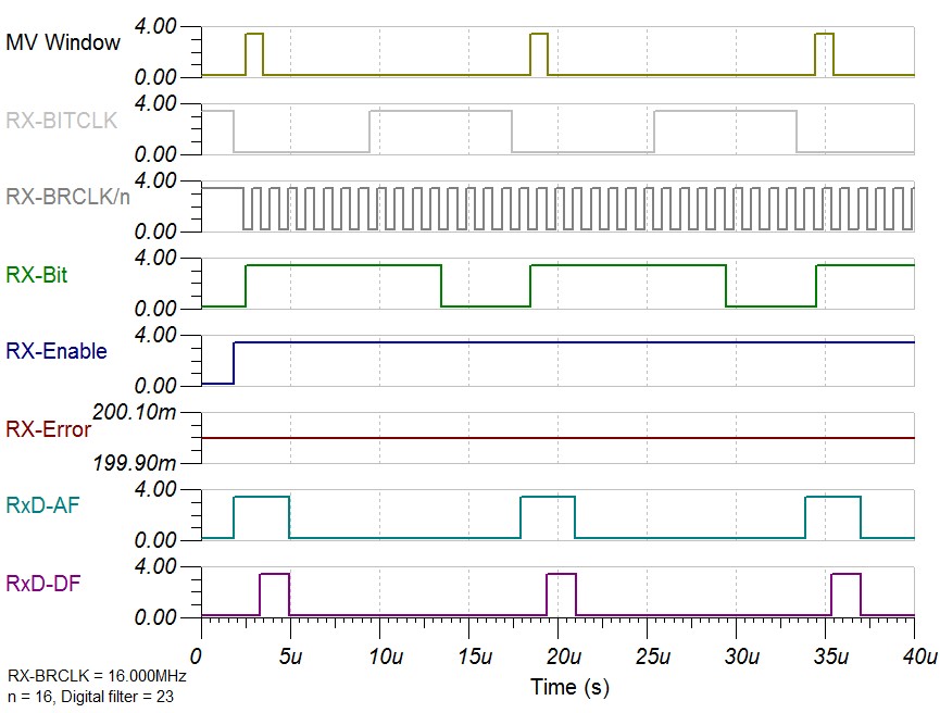

    I made a simulation of the USCI module. I don’t know what happens exactly inside the module but I tried my best, maybe others can clarify more about the precise working.
    Here the results at different frequencies, min 15.82MHz max 16.07MHz -1.125% +0.438%. The BRCLK is divided by 16 = baud rate 62,500.
    Unless the clock frequency of the USCI module is unstable I don’t believe the USCI is causing your problems. I believe more the statement from OCY about the TFDU4101 IRDA transceiver.
    Hopefully this can helps you to get a deeper inside view in the problem.
  • Oops, didn’t notice that the high frequency simulation has an error. Here the right one but with a digital filter of 12.
