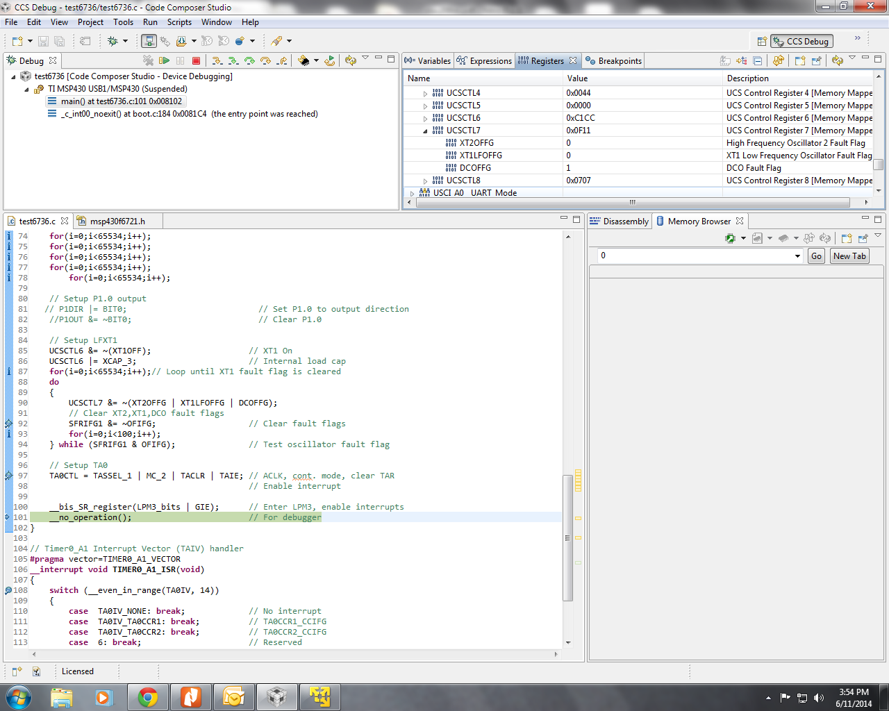

here i attach 2 screen shots .in which you can see that there is DCOFF and OFIFG flag is set still execution beat do- while loop and  reach to (__no_operation()) instruction how this possible????
so please guide how to get crystal working.

  • > How do you now that your crystal does not work?
    - The reason why I asked is in the first screen capture you've attached the value of XT1LFOFG is 0. Which should mean that nothing wrong with XT1... Can you also attach screen capture where registers UCSCTL0 - UCSCTL3 are also visible? Also instead of going to LPM3 mode can you put there just some dummy infinite loop and set debugger break point inside it?

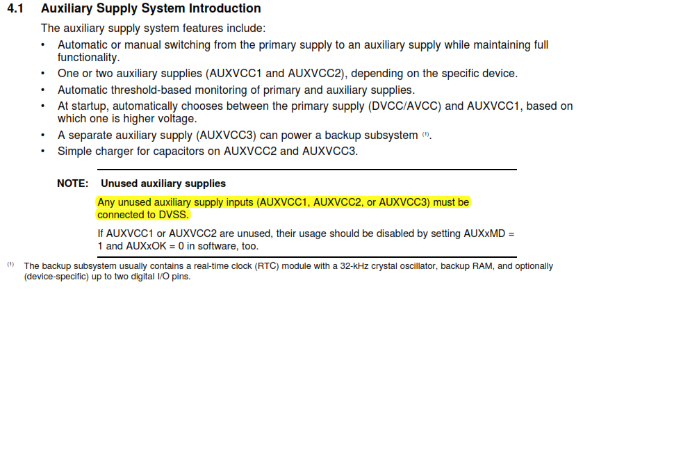

  • Unfortunately you did not provide schematic for your board, but just in case, do you use some back-up supplies in your system apart of main Vcc? If not, did you connect AUXVCC1-2 pins to DVSS and AUXVCC3 to Vcc? If the AUXVCC3 pin on your device in not connected to Vcc, XT1 oscillator is not even powered-up. This may look obvious, but sometimes can be overlooked on hardware design stage...
  • i am not using auxiliary supply apart from vcc.i connect AUXVCC1,AUXVCC2 ,AUXVCC3 to ground. as per note in user guide....
    here i attach screenshot...........
    so where should i connect it to vcc or ground????
  • AUXVCC3 MUST be connected to Vcc!!!  The user's guide just does not have very accurate description of it.
    It says that "...unused AUXVCC3 must be connected to DVSS." It means that if you do not use RTC, XT1, backup RAM then you must connect AUXVCC3 to DVSS. In your case you do use at least XT1 of the above, so you can not connect it to DVSS, but must connect it to Vcc. In the text above, it is actually mentioned in sub note (1).

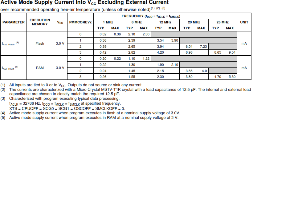

    i want to know how much average current it takes to charge?
  • pmcore setting lowest,smclk=mclk=1mhz
    so dose it mean while code is being executed it consume 0.32ma and ram consume 0.2ma?????? can you clarify this?
  • You'd better not rely on internal charger. Just connect AUXVCC3 to Vcc externally. You are not going to provide backup battery operation anyway, are you?
    The capacitor value for AUXVCC3 is in spec, and is 0.47uF.

  • It means that the current draw is different whether you execute your program from flash or from RAM. Executing program from RAM is much more power efficient and for some cases it is desirable on power-up to copy your program to RAM and execute it from there. It saves power, but complicates programming, because the code must be position-independant. And a RAM space is much smaller than flash, so only small program can fit there.

  • Serge, the datasheet lists this requirement in the description of the auxiliary filter module. It’s easy to find if you know where to look J
    IIRC, it’s also found in the aux module description in the users guide, if you take a look at the drawings (not the text).
     Karan, The difference of your two codes is that in the first code, the program hangs in the while. Which is likely just a one-word branch instruction. This instruction is taken from the flash controller read cache, not from flash itself (after the first read), so in reality, this empty while loop does not run from flash at all.
    The second code is longer, the cache needs to constantly access flash and therefore it draws more. The ‘cache’ is just there because the flash is internally 32 bit while the CPU does 8 or 16 bit reads/writes/fetches – it is not the same as an x86 instruction cache, it has only 32 bit. But in this special case of an empty loop, where there is the same instruction executed over and over again, it really acts as a first level cache and prevents further flash access.
    If you take an MSP of 1x/2x/4x family, you won’t see this as the flash there is internally 16bit.
     Besides this, of course an instruction that does mathematical operations and memory read/write (a is a global var in memory) does use more parts of the CPU than just the empty loop (which only uses instruction fetch and decoding and program counter changes). So a (slightly) higher current is to be expected too.
    If you execute both codes in ram, you’ll likely see the very same current for the first, while the second is still higher, but not as much.
  • Jens-Michael, shouldn't it be more logical if this also is mentioned in UCS section of user's guide? It contains XT1 Oscillator paragraph which lists the conditions for XT1 to be enabled, there are 7 of them. But the major condition - presence of power on AUXVCC3 pin for the devices with aux module - is not there...
  • Agreed, it would be nice. Especially since people tend to only read (if at all) what they think they might need. (I once made this mistake too and it decreased my score at teh final secondary school examinations)
    But if everything that belongs to one module would be explained in the description where it could be useful for, then the users guide would have a million pages.
    (e.g. use of timers in the ADC chapter, clock system in timer/UART/ADC chapters, port pins in every module chapter where there is an external connection used etc.)
    Well, that’s why the forum is there and we can help if someone missed an important detail J
