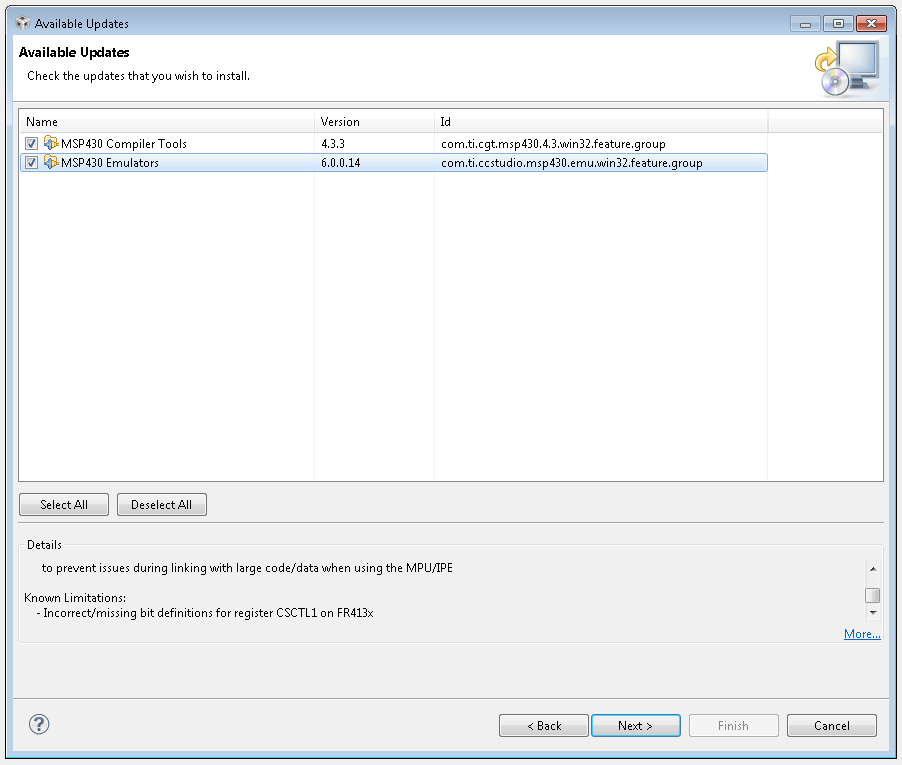

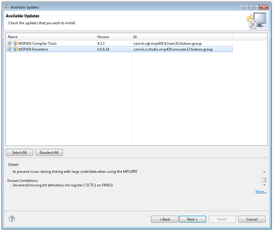

TI is currently working on an updated MSP430 device support package as well as a new compiler package addressing those issues, which will be deployed to all CCSv6.0.0 customers through the CCS IDE’s built-in update mechanism by 7/7/14.
For new features, device additions and these fixes please check for updates in CCSv6 (Help -> Check for Updates).
