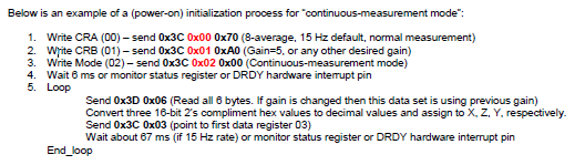

HMC5883L i2c problem
Other Parts Discussed in Thread: MSP430F5529
I am using msp430f5529 and I have some communicate  problem with the HMC5883L magnetometer via i2C. I had made a lot of tries but I can not read any data from it.  I tried to write the next OPERATIONAL EXAMPLES that writen in the datasheet but it dosent work. I would like to hear ideas what is the problem in my code.
here is my code:

  • It looks like you are sending the start byte (0x3c) as data. You must not do it. The UCB1I2CSA register gets the slave address. When setting the UCTXSTT bit, the USCI will automatically assemble the proper start byte and send it. The TXBUF only takes plain data.
  • So I should not suppose to use the start bit in anyway?  Does it done automatically?
    I will try it tomorrow.

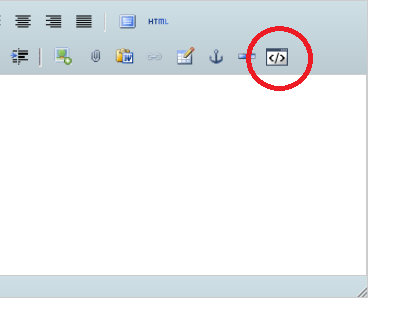

  • Also, please use the code formatter when posting code to the forum.
  • Hi ,
    Thanks for your help. I tried what you said and I stopped sending the start byte (0x3c, 0x3d), and I rearrange my code a little bit but, I am still receiving constant data that does not change. I would like to hear any  ideas what may be the problem in my code (my source code is below).
    Yes, the USCI assembles and sends the start byte(!) and check the ACK on its own when you set the UCTXSTT bit. TXBUF is only for plain data.
