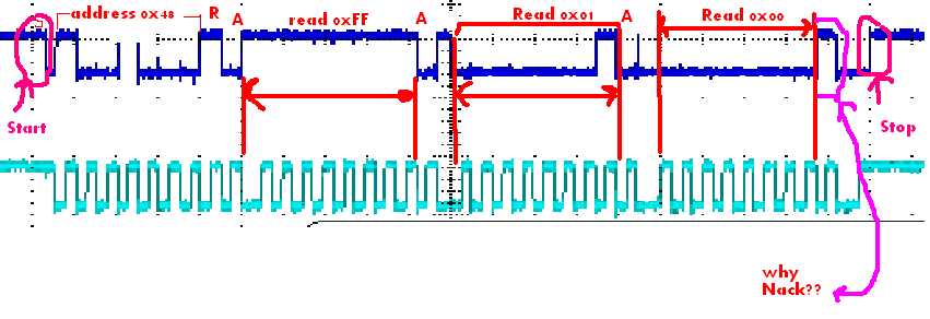

I’m using the msp430f5438A, with CCs 5.3.
And I want to use with the I2C module ( my first time) in order to read data from I2c simulator (AARDVARK I2c simulator)
I get the following wave diagram:
i use the following code:

I want to emphasize:
1. all the data read correctly from the simulator ( 0xFF 0x01 0x00)
2. in the above code , i record the data and the accompanying nack/ack . no nack is record. the nack recognize
only by scope. without observing the data by the scope i wouldn't recognize the problem.
is anyone can explain the Nack appearance ?
