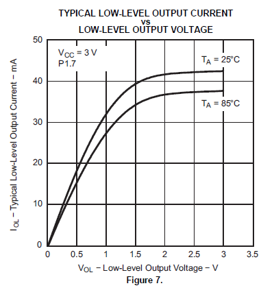

    It is hard to understand what you mean. Are you saying that you are powering msp430 from 5V supply and mp430 pins shall have either 0V and 5V output levels? - Msp430 power shall not exceed 3.6V
    david hormaza said:
    However when the sources has the minimum current to turn on the system, the outputs from the MSP draws 1.7 V instead of 0V.
    You want to say that msp430 does not pull it's pin strong enough? Mps430 outputs are not so strong, refer to graph from datasheet below. If you want stronger "pull" - use N-FET transistor as switch
