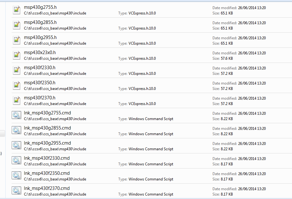

    Yes, if you browse with Windows Explorer to C:\ti\ccsv6\ccs_base\msp430 and then write "Content: *TRAPINT*" in the search bar at the top right corner you'll see all the files which have that. Here are the ones that I see.
    If you open for instances lnk_msp430g2330.cmd (it is a valid filename on my ccsv6 installation) and look for TRAPINT you'll find:

    Anyway, it would be good to extend the workaround description in the device errata to alert for the linker command file change. The information is scattered around different documents so sometimes it's a bit hard to figure out what is going wrong. It could also be my misconception as I wouldn't expect having to do changes to tools related files.
