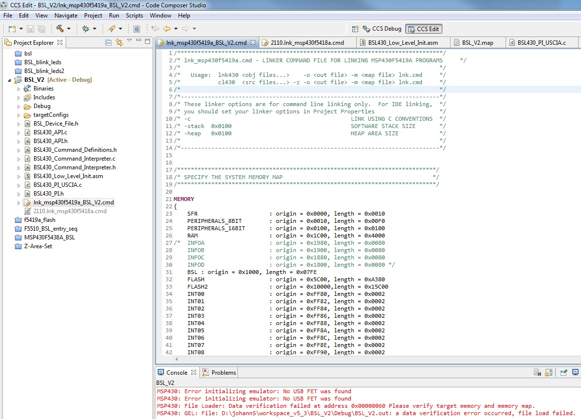

I'm also using the MSP430F5419A and want to load my custom BSL.
I have problems with the linker cmd file in CCS. Could you post me how you modivied it for your bsl-application? Or maybe post the file directly?
Thx, Hans
  • Oh and should add that i want to adapt the MSP430F5438A_BSL that i found in the SLAA450_custom_BSL.zip in the folder 5xx_6xx_Example_BSL_Source  to my MSP430F5419A.
    I allready trieded to modify the linker cmd accordingly to the slaa450c 2.3.1.2 and it did not work.
    CCS tells me when loading:
    MSP430: File Loader: Data verification failed at address 0x00000000 Please verify target memory and memory map.
    MSP430: GEL: File: D:\johannS\workspace_v5_3\CUSTOM_BSL\BSL\BSL.out: a data verification error occurred, file load failed.

  • Hi Katie,
    thank you for your posts. they were helpful :)
    But I'm still having still trouble with uploading my code to the MSP430F5419A:
    So i better start to tell you what i did:
    1) i created a new project for my device and configured the project with the correct download options like: check for Allow Read/... to BSL memory, erase main, info and protected info memory and copied the files from 5xx_6xx_Example_BSL_Source (i even tried the optimisation that was mentioned in an other post)
    2) Modified the created linker file from CCS accordingly to the Slau208n
    Here is my linker file:

    i also tried adapting the linker file from the 5xx_6xx_Example_BSL_Source like:
    /* Copyright (c) 2013, Texas Instruments Incorporated                           */
    /*  All rights reserved.                                                        */
    /*  Redistribution and use in source and binary forms, with or without          */
    /*  modification, are permitted provided that the following conditions          */
    /*  are met:                                                                    */
    /*  *  Redistributions of source code must retain the above copyright           */
    /*     notice, this list of conditions and the following disclaimer.            */
    /*  *  Redistributions in binary form must reproduce the above copyright        */
    /*     notice, this list of conditions and the following disclaimer in the      */
    /*     documentation and/or other materials provided with the distribution.     */
    /*  *  Neither the name of Texas Instruments Incorporated nor the names of      */
    /*     its contributors may be used to endorse or promote products derived      */
    /*     from this software without specific prior written permission.            */
    /*  THIS SOFTWARE IS PROVIDED BY THE COPYRIGHT HOLDERS AND CONTRIBUTORS "AS IS" */
    /*  AND ANY EXPRESS OR IMPLIED WARRANTIES, INCLUDING, BUT NOT LIMITED TO,       */
    /*  THE IMPLIED WARRANTIES OF MERCHANTABILITY AND FITNESS FOR A PARTICULAR      */
    /*  PURPOSE ARE DISCLAIMED. IN NO EVENT SHALL THE COPYRIGHT OWNER OR            */
    /*  CONTRIBUTORS BE LIABLE FOR ANY DIRECT, INDIRECT, INCIDENTAL, SPECIAL,       */
    /*  EXEMPLARY, OR CONSEQUENTIAL DAMAGES (INCLUDING, BUT NOT LIMITED TO,         */
    /*  PROCUREMENT OF SUBSTITUTE GOODS OR SERVICES; LOSS OF USE, DATA, OR PROFITS; */
    /*  OR BUSINESS INTERRUPTION) HOWEVER CAUSED AND ON ANY THEORY OF LIABILITY,    */
    /*  WHETHER IN CONTRACT, STRICT LIABILITY, OR TORT (INCLUDING NEGLIGENCE OR     */
    /*  OTHERWISE) ARISING IN ANY WAY OUT OF THE USE OF THIS SOFTWARE,              */
    /*  EVEN IF ADVISED OF THE POSSIBILITY OF SUCH DAMAGE.                          */
    /* lnk_msp430f5418a.cmd - LINKER COMMAND FILE FOR LINKING MSP430F5418A PROGRAMS     */
    /*   Usage:  lnk430 <obj files...>    -o <out file> -m <map file> lnk.cmd     */
    /*           cl430  <src files...> -z -o <out file> -m <map file> lnk.cmd     */
    /* These linker options are for command line linking only.  For IDE linking,  */
    /* you should set your linker options in Project Properties                   */
    /* -c                                               LINK USING C CONVENTIONS  */
    /* -stack  0x0100                                   SOFTWARE STACK SIZE       */
    /* -heap   0x0100                                   HEAP AREA SIZE            */
    /* SPECIFY THE SYSTEM MEMORY MAP                                            */
    MEMORY
        SFR                     : origin = 0x0000, length = 0x0010
        PERIPHERALS_8BIT        : origin = 0x0010, length = 0x00F0
        PERIPHERALS_16BIT       : origin = 0x0100, length = 0x0100
        RAM                     : origin = 0x1C00, length = 0x4000
    //    INFOA                   : origin = 0x1980, length = 0x0080
    //    INFOB                   : origin = 0x1900, length = 0x0080
    //    INFOC                   : origin = 0x1880, length = 0x0080
    //    INFOD                   : origin = 0x1800, length = 0x0080
        ZAREA                   : origin = 0x1000, length = 0x0010
        BSL430_VERSION_VENDOR   : origin = 0x1010, length = 0x0001
        BSL430_VERSION_CI       : origin = 0x1011, length = 0x0001
        BSL430_VERSION_API      : origin = 0x1012, length = 0x0001
        BSL430_VERSION_PI       : origin = 0x1013, length = 0x0001
        ZAREA_CODE              : origin = 0x1014, length = 0x002E
    //    FLASH                   : origin = 0x1042, length = 0x07AE  //????????????????
        BSLSIG                  : origin = 0x17F0, length = 0x000C
        JTAGLOCK_KEY            : origin = 0x17FC, length = 0x0004
    //    FLASH2                  : origin = 0x10000,length = 0x15C00
        FLASH                   : origin = 0x5C00, length = 0xA380
        INT00                   : origin = 0xFF80, length = 0x0002
        INT01                   : origin = 0xFF82, length = 0x0002
        INT02                   : origin = 0xFF84, length = 0x0002
        INT03                   : origin = 0xFF86, length = 0x0002
        INT04                   : origin = 0xFF88, length = 0x0002
        INT05                   : origin = 0xFF8A, length = 0x0002
        INT06                   : origin = 0xFF8C, length = 0x0002
        INT07                   : origin = 0xFF8E, length = 0x0002
        INT08                   : origin = 0xFF90, length = 0x0002
        INT09                   : origin = 0xFF92, length = 0x0002
        INT10                   : origin = 0xFF94, length = 0x0002
        INT11                   : origin = 0xFF96, length = 0x0002
        INT12                   : origin = 0xFF98, length = 0x0002
        INT13                   : origin = 0xFF9A, length = 0x0002
        INT14                   : origin = 0xFF9C, length = 0x0002
        INT15                   : origin = 0xFF9E, length = 0x0002
        INT16                   : origin = 0xFFA0, length = 0x0002
        INT17                   : origin = 0xFFA2, length = 0x0002
        INT18                   : origin = 0xFFA4, length = 0x0002
        INT19                   : origin = 0xFFA6, length = 0x0002
        INT20                   : origin = 0xFFA8, length = 0x0002
        INT21                   : origin = 0xFFAA, length = 0x0002
        INT22                   : origin = 0xFFAC, length = 0x0002
        INT23                   : origin = 0xFFAE, length = 0x0002
        INT24                   : origin = 0xFFB0, length = 0x0002
        INT25                   : origin = 0xFFB2, length = 0x0002
        INT26                   : origin = 0xFFB4, length = 0x0002
        INT27                   : origin = 0xFFB6, length = 0x0002
        INT28                   : origin = 0xFFB8, length = 0x0002
        INT29                   : origin = 0xFFBA, length = 0x0002
        INT30                   : origin = 0xFFBC, length = 0x0002
        INT31                   : origin = 0xFFBE, length = 0x0002
        INT32                   : origin = 0xFFC0, length = 0x0002
        INT33                   : origin = 0xFFC2, length = 0x0002
        INT34                   : origin = 0xFFC4, length = 0x0002
        INT35                   : origin = 0xFFC6, length = 0x0002
        INT36                   : origin = 0xFFC8, length = 0x0002
        INT37                   : origin = 0xFFCA, length = 0x0002
        INT38                   : origin = 0xFFCC, length = 0x0002
        INT39                   : origin = 0xFFCE, length = 0x0002
        INT40                   : origin = 0xFFD0, length = 0x0002
        INT41                   : origin = 0xFFD2, length = 0x0002
        INT42                   : origin = 0xFFD4, length = 0x0002
        INT43                   : origin = 0xFFD6, length = 0x0002
        INT44                   : origin = 0xFFD8, length = 0x0002
        INT45                   : origin = 0xFFDA, length = 0x0002
        INT46                   : origin = 0xFFDC, length = 0x0002
        INT47                   : origin = 0xFFDE, length = 0x0002
        INT48                   : origin = 0xFFE0, length = 0x0002
        INT49                   : origin = 0xFFE2, length = 0x0002
        INT50                   : origin = 0xFFE4, length = 0x0002
        INT51                   : origin = 0xFFE6, length = 0x0002
        INT52                   : origin = 0xFFE8, length = 0x0002
        INT53                   : origin = 0xFFEA, length = 0x0002
        INT54                   : origin = 0xFFEC, length = 0x0002
        INT55                   : origin = 0xFFEE, length = 0x0002
        INT56                   : origin = 0xFFF0, length = 0x0002
        INT57                   : origin = 0xFFF2, length = 0x0002
        INT58                   : origin = 0xFFF4, length = 0x0002
        INT59                   : origin = 0xFFF6, length = 0x0002
        INT60                   : origin = 0xFFF8, length = 0x0002
        INT61                   : origin = 0xFFFA, length = 0x0002
        INT62                   : origin = 0xFFFC, length = 0x0002
        RESET                   : origin = 0xFFFE, length = 0x0002
    /* SPECIFY THE SECTIONS ALLOCATION INTO MEMORY                              */
    SECTIONS
        .bss        : {} > RAM                /* GLOBAL & STATIC VARS              */
        .data       : {} > RAM                /* GLOBAL & STATIC VARS              */
        .sysmem     : {} > RAM                /* DYNAMIC MEMORY ALLOCATION AREA    */
        .stack      : {} > RAM (HIGH)         /* SOFTWARE SYSTEM STACK             */
    	.ZAREA      : {} > ZAREA
    	.BSL430_VERSION_VENDOR : {} > BSL430_VERSION_VENDOR
    	.BSL430_VERSION_CI     : {} > BSL430_VERSION_CI
    	.BSL430_VERSION_API    : {} > BSL430_VERSION_API
    	.BSL430_VERSION_PI     : {} > BSL430_VERSION_PI
    	.ZAREA_CODE : {} > ZAREA_CODE
    	.BSLSIG     : {} > BSLSIG
    	.JTAGLOCK_KEY : {} > JTAGLOCK_KEY
        .text       : {}>> FLASH | FLASH2     /* CODE                              */
        .text:_isr  : {} > FLASH              /* ISR CODE SPACE                    */

        TIMER0_B0    : { * ( .int60 ) } > INT60 type = VECT_INIT
        UNMI         : { * ( .int61 ) } > INT61 type = VECT_INIT
        SYSNMI       : { * ( .int62 ) } > INT62 type = VECT_INIT
        .reset       : {}               > RESET  /* MSP430 RESET VECTOR         */
    /* INCLUDE PERIPHERALS MEMORY MAP                                           */
    -l msp430f5419a.cmd //i edited
    But i always get the error while loading:
    MSP430: File Loader: Data verification failed at address 0x00000060 Please verify target memory and memory map.
    MSP430: GEL: File: D:\johannS\workspace_v5_3\BSL_V2\Debug\BSL_V2.out: a data verification error occurred, file load failed.
    Do you know what my problem could be?
    Thx,
    Hans
  • Hi Hans,
    Have you tried using the un-altered linker file from the 5xx_6xx_Example_BSL_Source?
    http://e2e.ti.com/cfs-file.ashx/__key/communityserver-discussions-components-files/166/0066.lnk_5F00_msp430f5418a.cmd Simply build the whole project for F5418A - it will probably give you a warning when you go to load it into the part about this not matching your F5419A but the F5418A memory should fit in F5419A just fine.
    If you just import and build the project from 5xx_6xx_Example_BSL_Source into CCS without any alteration, are you able to load it? Are you able to load any other programs (non-BSL programs) without issue on your same board/tool setup?
    Katie
  • Hello Katie,
    thank you very much for your help. Now i can start trough with altering the code for my project :)
    I just needed to mark the checkboxs in CSS as described in:
    http://processors.wiki.ti.com/index.php/MSP430_FAQ#How_to_enable_the_access_to_BSL_Flash_memory_in_MSP430F5xx.2F6xx_devices_.3F
    and it worked :)
    Hans
