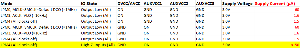

  • Hi Jacob,
    I ran through some tests in the lab on an MSP430F6736 (this device is the family superset to your device).  I captured LPM0, LPM3, and LPM4 currents when powered from DVCC/AVCC or from AUXVCC1.  I did not see any differences at the microamp level between DVCC/AVCC and AUXVCC1, and I met or exceeded the datasheet values in each case.  For completeness, I ran an example with the digital IO's all left as high impedance inputs.  In this case, the power consumption went up significantly- to around 150uA in LPM4.  It should be <2uA.  I also found that the current was somewhat unpredictable, and varied depending on whether I hovered my hand over the pins or not.  Upon returning all of the pins to output low, the current again dropped back to 1.5uA as expected.  I do believe that the boot code in the device leaves the IO pins as high-z inputs to protect the device and any other circuitry (this is the default configuration out of reset).
    I recommend that you try setting all of your unused pins to output low, then re-measuring.  For my tests, I used the following simple source.  Note that I set ACLK to be driven from the VLO, not the crystal- as I did not have a crystal on my test board.  Numbers in LPM3 and LPM4 might be a little higher with a 32kHz crystal, but not much.

    I am a little concerned about having external pullups to DVCC.  This may not provide the expected operation when DVCC goes down and the device runs off of AUXVCC1.  The IO rails are powered off of DVSYS, which is externally connected to VDSYS (the digital supply rail internally).  I want to check with someone more familiar with the device to determine the best way to handle external pullups. It could be that because DVCC was not connected in your test,  that outputting a logic high voltage onto an IO line caused a voltage to then appear on DVCC through the external pullup on that pin (which was previously unconnected).
