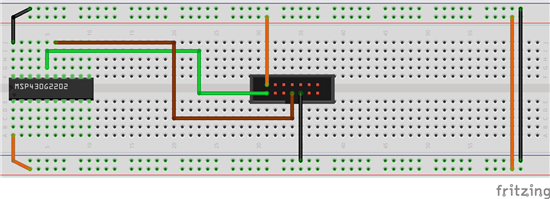

I have since got the MSP-FET programming chips and am now trying to blow the JTAG fuse.
I first tried using the programming setup that I found worked fine and it would not blow. Here's the wiring for that

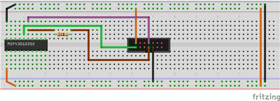

I then done some more Googling and found that for fuse blow support the TCK pin must be connected through a 330Ohm resistor and TEST (Pin 8) needed to be connected to the chip after the resistor. I found that the device allowed programming and debugging via the 330Ohm but after connecting Test I was prevented from doing any programming or debugging. In both cases the fuse blow did still not work either.
Here's the wiring for that.
I also tried putting a 47k Pull up resistor for reset with no change. Capacitors between VCC and Ground (100NF non polarised) and no difference at all. So any ideas on why it won't blow the fuse?

  • Hell Ryan,
    Please see our HW User Guide (located here) for proper connections for your SBW connections, specifically Figure 2-2 will be of use to you. Please also note for proper SBW communication, the cap C1 in the figure cannot exceed 2.2nF.
    JH
  • So are you meant to add the capacitor? From what I could tell on many diagrams it said it was the maximum theoretical limit and should not be added and that it shouldn't be added unless required? But what is it required for?
  • “unless required” means, when you have a power supply that raises only slowly (few V/ms), the MSP could be released from brownout reset and start to run while the supply is still too low for operation (or even drops a bit again due to the rising load). This could crash the MSP and prevent it form starting. Adding a capacitor (and a pull-up) makes RST follow VCC with a delay, as long as VCC is still rising. This keeps the MSP in reset until VCC doesn’t rise anymore.
    If SBW isn’t used (but 4-wire JTAG), then 100nF and a 47k-100k pull-up are a good combo for almost every situation.
