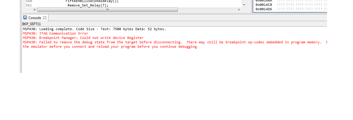

ccs error
Other Parts Discussed in Thread: MSP430F5338
Hello
I am using MSP430F5338 in my current design.
Sometimes debugger stop responding and shows following error.
Can you pls let me know the exact reason behind this problem.
I have already disable software break points.
RESUME BUTTON - disable
SUSPAND BUTTON -disable
TERMINATE BUTTON - Enable , but unable to terminate it .
manish
  • Mostly caused by a hardware error; Too long or bad USB cable. Using USB Hub. Too long and too high capacitance of connection between FET and Board. Too high capacitance on the board on the MCU pins; RST, TEST or TDO, TDI, TMS, TCK.
