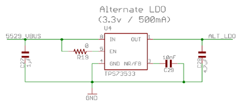

    It looks like Vusb is grounded through a 0.22 pF capacitor. Did you mean to add the 200 ohm resistor to Vbus?
  • Tod,
    I don’t know what board you are using and how easy it is to add a resistor but I meant in series from the USB connector Vbus to the 3.3V LDO input, close to the LDO there will be already a capacitor.
  • Thanks for clarification, Leo.
    Yes, I will consider this!
  • This is the alternate LDO from the 5529 Experimenter's Board Schematic. We have a similar LDO. You are suggesting that I cut the line just below "_VBUS" and add a 200 ohm resistor in its place, correct?
  • Using the F5529 EVM and the upper right USB connector you can just replace JP15 with a resistor.
