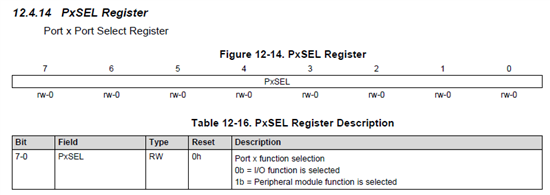

    However, If you look at this snapshot from the datasheet:
    It shows that the default operation of P2SEL will be I/O function. So this should disconnect the USCI module altogether.
    Looking at the default values of the registers, You can come to the following block diagram:
    This leads me to believe that the IO pins should be in a high impedance state during a reset, if during a reset does the same to the registers as after a reset, except that the PC is not allowed to advance.

  • Leo, I don’t think your explanation is completely correct. And I can understand Jonathan’s concerns.
    There are several states in the timing.
    First there is BOR. It will pull RST down internally.
    BOR, when voltage rises across the threshold, will release RST after some additional internal delay (this may be too short in case of Vcc only slowly rising. This is where the capacitor on RST comes into play.
    Once RST is released, boot code will execute. This boot code will do the configuration of the modules and do the default pin mapping, depending on BOR, POR(RST) or PUC causing it to execute.
    However, some things must be done even before the boot code will execute. Like switching the clock system back to defaults. If e.g. MCLK was too high for the current core voltage, a reset wouldn’t allow the boot code to execute and reset the clock system, if MCLK were still too high. It would simply crash one more.
    So some things have to be done in hardware by the RST signal.
    My guess (and it is only a guess, as the users guide does not confirm it) is that the PxSEL bits are set back to default (this makes it unimportant whether the modules are initialized or not) and the ports are switched to inputs, with pull-ups disabled. And the DCO is reset to default (with MCLK on DCO). And likely, the reset of the status register is also done by the RST signal (an active IRQ with GIE still set would perhaps crash the system before the boot code can do anything)
    Then the boot code can kick-in and do its job. Which takes the said 1-3ms, depending on how much is to do (POR or PUC init)
    Anything else won’t make sense, as it then could happen that as long as BOR is active, the port pins still have an active output state. Or, if power was really down, could have a random state.  Which would be bad not only regarding energy waste.
