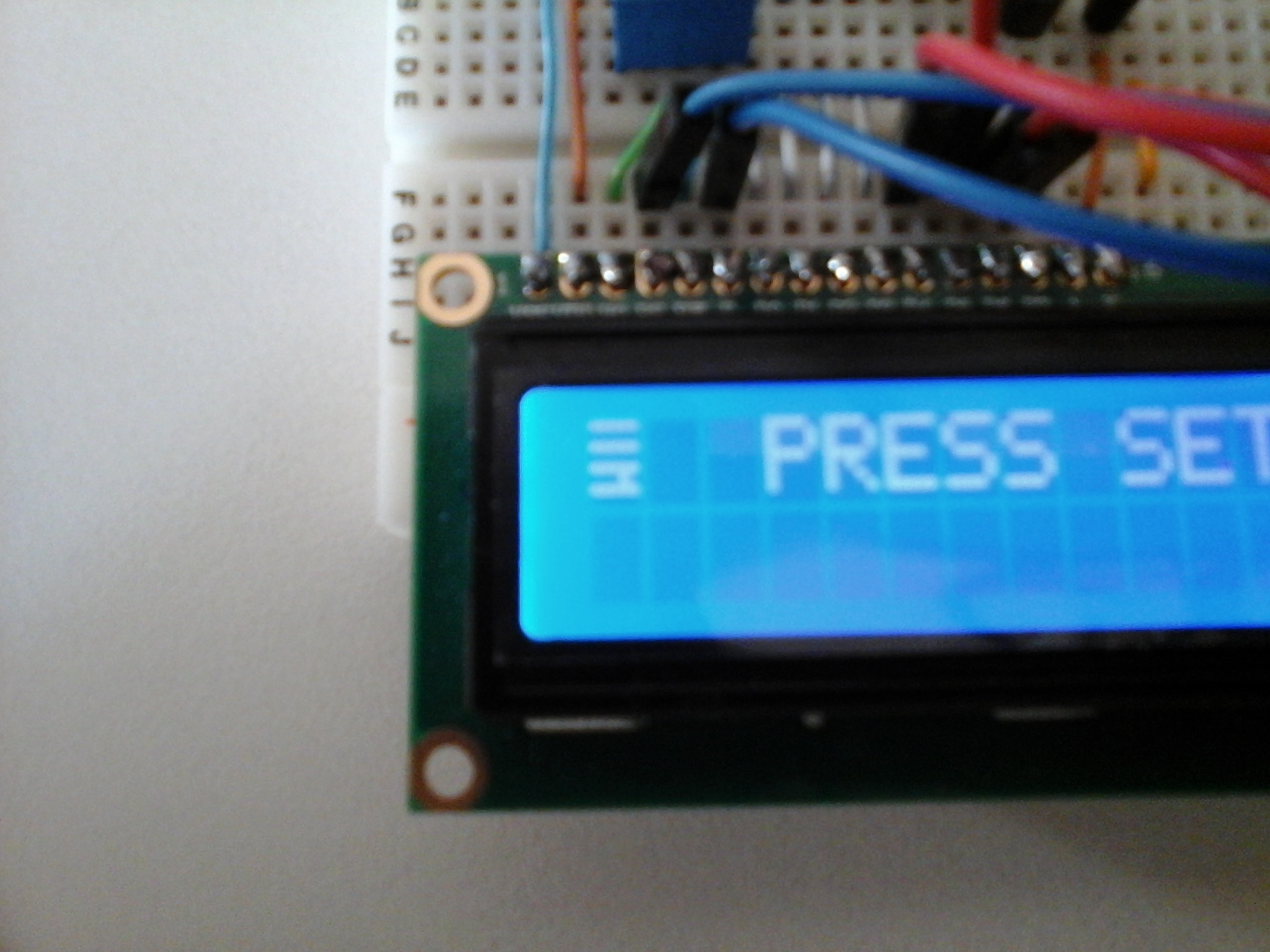

Hello fellows,
I have spent much time trying to solve an issue in my application,with the hope that they can help me, I decided to ask for your help once again.
So I'm trying to show some symbols in my msp430g2553, but the characters appear wrong. The symbol is the symbol of battery.

  • It's good that you've posted the full code, but I have a few questions that aren't covered in your post:
    First of all, what LCD display are you using?
    Have you tried any simpler test cases (and did they work)? Assuming this is an alphanumeric display, have you been able to display ordinary text with the built-in font?
    Finally, what specifically is wrong about the appearance of the custom symbols? Ideally upload a picture showing what you expect the display to look like and what it actually shows when your code is run.
  • I'm sorry my fault....Thanks for answering, well it is a display 16x2 Hitachi. And I made many tests, yes I'am able to display any number or text, just the symbols comes corrupted...
    as you can see in the picture below, would be to show a battery symbol
    Pin connections
    P1.3---->RS
    P2.5---->E
    P2.1---->D4
    P2.2---->D5
    P2.3---->D6
    P2.4---->D6
  • armandoferr said:
    P2.3---->D6
    P2.4---->D6
    I'm assuming that should say P2.4---->D7.
    Anyway, I haven't noticed anything obviously wrong with the symbol upload process.
    It might be worth trying to read back the contents of CGRAM to see if it contains the uploaded data. Also, try reading it before sending your custom symbols it to see that it starts out cleared, or at least different to what's there after you upload.
  • Robert cows ill can you give me some examples . Tanks in advance
  • Hey armandoferr!
    What examples do you need? Your code is already working, there is just a small issue with your selfmade CG ROM characters. Try the suggestions Robert has made.
