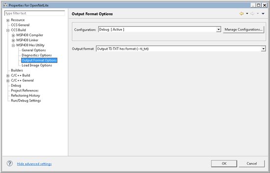

first time msp430 programmer here, hope to get some help on how to download my application program into the MSP-TS430PN80USB board.
i have two eval boards: MSP-EXP430F5529LP and MSP-TS430PN80USB. both got the same 5529 chip on them. from reading the website, it seem i need to have the MSP 430 FET in order to program my eval boards. however, i read through the SLAA478 application note and that's how i decided to buy the MSP-TS430PN80USB board and the note didn't mentioned explicitly a 430 FET is needed, it seems the board can be directly connected and programmed on it's USB port. i searched this forum, this seems can be done using the bootstrap loader according to Leo (http://e2e.ti.com/support/microcontrollers/msp430/f/166/p/125237/531006.aspx#531006). so i went ahead downloaded the MSP430 USB Firmware Updater, but it looking for a .txt file for as the firmware, where do i got this file?
my application program is also from the same SLAA478 source. which is provided as a CCS project folder, but when i try to compile it in CCS, it run into error as the compiler is looking for that MSP430 FET.
