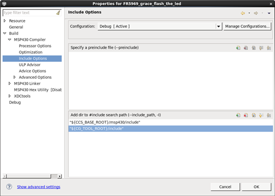

    CCS should be looking for the files in the include directory in the compiler installation directory, which in your case is C:\ti\ccsv6\tools\compiler\msp430_4.3.3\include
    Chris Humme said:
    I don’t know if that is the problem and if it is how to direct CCS6 to those files.
    In the Include Options in the CCS project properties there should a entry for "${CG_TOOL_ROOT}/include" in the #include search path which allows CCS to find the stdint.h and intrinsics.h include files:

    I looked and the “${CS_TOOL_ROOT}/include” entry was in the #include search path as your screen capture showed. BTW thank for the screen capture rather than just saying include options and leaving me to hope I had found what you were describing.  The value for the system environmental variable CG_TOOL_ROOT is c:/ti/ccsv6/tools/compiler/msp430_4.3.3 which seems correct. What seemed wrong was that there is no copy of driverlib.h in the directory c:/ti/ccsv6/tools/compiler/msp430_4.3.3/include.
