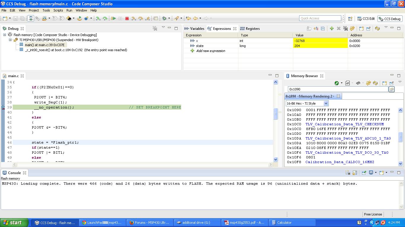

Hi Every one,
i want to retain data after power loss,and i have almost gone lot of threads in the forum, but i didn't achieve what i need!
 So i have decided to post it agian pl kindly let me know what is the fault.
Here was my plan to know the variable data is stored during power loss or not
in main's while loop using a switch performing write operation,next read that variable if the value read matches with the known value led is ON if not OFF.
Now if i press the switch with the launch pad connected to the programming pins of the controller ,the read value is matching and led is ON,and if i remove the programming pins form the launch pad it is OFF.
i have developed this code with the help of  TI sample example code of flash in MSP430G2553 and from forum posts

Write function is writing that particular value to 0x1000 location i have checked in memory browser in run mode.and even it is reading properly but that read value is lost when the power is off.or my entire program and understanding is faulty , which am unable to find it out.

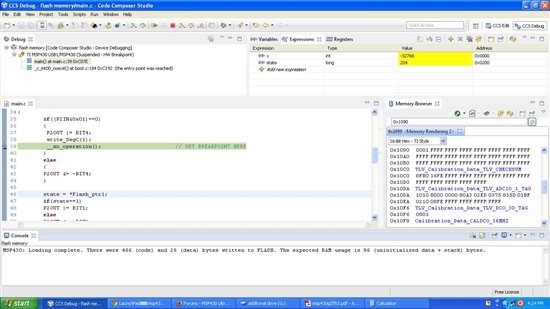

    Be sure CCS is not erasing Info Memory -> Properties\Debug\MSP430 Properties.
    I don’t know how did you check the FLASH-byte after boot, but you should on CCS connect run to main (and Stop) or place a break point before the while(1) loop and read the FLASH contents.
  • I have checked MSP430 Properties ,it is erase main memory only
    and i have checked the contents of the memory  with break point on  the _no_operation() function pl check attached
    i  suspect now my flash is expired ,i will check once again and i will replace the MCU and this time i will execute write only one time.
  • Now you are checking after the write, you must do it before!
    But I think I see the problem; You assign the FLASH address to your Flash_ptr1 variable only when writing after that reading will be ok. But you must assign the address also before reading the byte.
  • i think that was the problem,because after assigning address in read function led is ON even after power off condition,so MCU flash is safe i presume.and also my checking was also wrong i need to check it before the write whether the data is still in the specified location am i right ?
