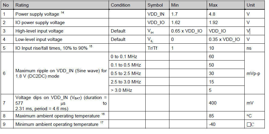

Is it possible to set these pins around 1.8 volt when the pins are high? The reason that i post this question is that we want to use one of the PU pins as a output pin. On the other end want to connect a Input pin of the PAN1326 Bluetooth chip. We want to connect the nshutdown pin to PU1.
But in the PAN1326 data sheet in the recommended table we see a lower recommeded  I/O voltage (max 1.92).
Does anybody have a sugesstion? Is using a normal I/o pin a good suggestion?

    Does anybody have an idea if it is possible to connect a ~1.8 - 1.9 volt input pin of the PAN1326 to one of the PU pins? Because of the higher voltage, in the MSP datasheet says that the minimum output voltage is 2.4 volt.
  • You can always drive a lower-voltage input by a higher voltage port pin. Just connect the input with a pull-up to its supply (1.8V then) and put a diode between the output and the input. This way, you turn the output into an open-collector output that will either drive the input low or release it to its pull-up.
    However, it takes two external parts to do so. Of course, this way you can only sink a current, not source it.
    If you want to source a current, you can limit the output voltage by putting a zener diode in series. For a low-impedance load, this will cause a voltage drop so the ‘output’ voltage is low enough and still a significant current flows (other than with a series resistor).

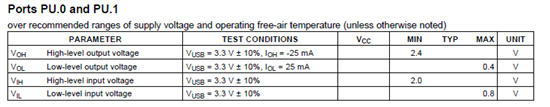

    Thank you for your reply! We have a quick follow up question about the PU pins. When we use the MSP430F5359 where the USB is disabled and we feed the MCU with a external current of 1,85v. One of our hardware people says that by giving a 1,85v external  current that the I/O voltage is then also 1,85.
    But we are not sure of this because the datasheet has the following table:
    In this table we see that the minimal output voltage is 2,4 volt, this will cause a problem when connecting to our other device. So when we supply the MCU with 1,85v and using the PU as GPIO pins will this have a output voltage of 1,85 or a minimal 2.4 volt?
    Also in the datasheet we found the following passage:
    The Port U Pins (PU.0 and PU.1) function as general-purpose high-current I/O pins. These pins can only be
    configured together as either both inputs or both outputs. Port U is supplied by the LDOO rail. If the 3.3-V LDO is
    not being used in the system (disabled), the LDOO pin can be supplied externally.
    This means that the PU pins are special high current pins? And have not the same current as the normal GPIO pins?
  • The table is for VUSB=3.3V and a current of 25mA. So you have a voltage drop of less than 0.8V@25mA. For a smaller current, the output voltage drop is lower, almost reaching VUSB (3.3V) for no current (high-impedance).
    If you supply LDOO by 3.3V, and draw 25mA from the pin, you can expect to get an output voltage of >2.4V. That’s what the table tells. If you use a lower supply voltage, you’ll get a lower output voltage. Much lower, as lower supply means lower driving strength and therefore more voltage drop per current. If you’re unlucky, even the shortcut current on 1.85V will be below 25mA.
    Also, if running from 3.3V supply, input voltage must be at least 2.0V to be accepted as ‘high’ in any case.
    And yes, the PU pins have stronger output drivers than the normal I/O pins. (these have only <20mA shortcut current and about 14mA on a voltage drop of 0.8V for 3V supply, and <6mA on 1.8V)
