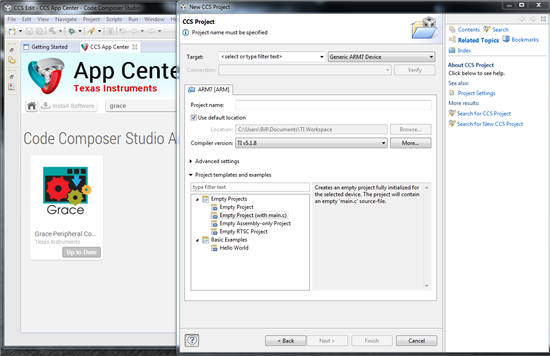

New Grace project not showing up after install.
Other Parts Discussed in Thread: MSP430G2553, MSP430F67641
I've just installed Code Composer  v6.0.1.00040 and installed the Grace plugin from the App Center. When I go to create a new project, there is no option for "Empty Grace (MSP430) Project." What can I do to fix this?

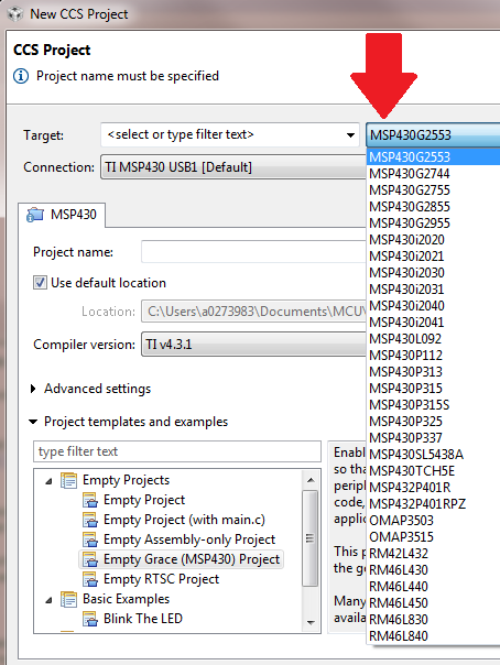

  • Hi Dru,
    It looks to me like you are not seeing Grace projects because your target is set to a Generic ARM7 Device, rather than an MSP430.  Try setting the Target: selection to the MSP430 device you would like to develop for.  Then you should see the Grace options appear (as below for an MSP430G2553):
    You probably installed ARM support with CCS and it defaulted to ARM7 rather than MSP430.
    Walter

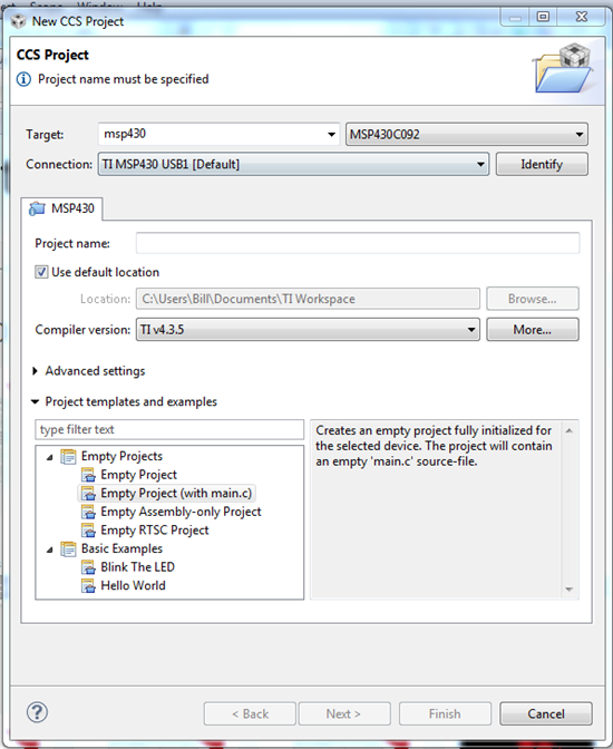

  • Hi Walter,
    I chose an MSP430 and I still don't see the grace project option.
  • Dru,
    I apologize for not being more clear.  The Grace feature does not support every device family.  The supported famlies are listed below:
    • MSP430G2xx Value Line Devices
    • MSP430F2xx Devices
    • MSP430FR57xx Devices
    • MSP430FR584x(1) Devices
    • MSP430FR585x Devices
    • MSP430FR586x(1) Devices
    • MSP430FR594x(1) Devices
    • MSP430FR595x Devices
    • MSP430FR596x(1) Devices
    You can find this list at the Wiki page here: http://processors.wiki.ti.com/index.php/Grace_Quick_Start_Guide
    The Code Composer Studio New CCS Project window is intelligent and only displays options that apply to specific devices.  This also applies to things like the DriverLib- you won't see an option for DriverLib when you select a MSP430G2xx device, but you will when you select an MSP430F5xx device.  Typically on the higher-performance families (F5xx, F6xx, FR5xx, FR6xx) Grace is not used as these families have peripheral driver libraries available.
    Which device are you looking to work with?
    Walter
  • Ok, now it is showing up, thanks! I'm working with an MSP430F67641. Grace is not available for this chip then?
  • Dru,
    That's correct.  If you are looking at getting up and running quickly with the F67641, I recommend taking a look at the driver library.
    You can find example projects that show how to use it in the TI Resource Explorer in CCS (by selecting the View -> Resource Explorer (Examples) menu option).
