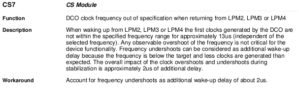

    The program uses DMA and enters LPM3. Therefore, maybe it is affected by the following MSP430FR5969 errata:
    Consider leaving running with zero wait states, but enter LPM0 instead of LPM3 and see if that stops the reset.
    [Errata DMA11 mentions a PUC reset rather than a ACCTEIFG reset, so may not be the cause]
  • There is also errata CS7 related to waking up from LPM2, LPM3 or LPM4:
    While the description on CS7 says "Any observable overshoot of the frequency is not critical for the
    device functionality", it not clear how long a frequency overshoot has to occur before a FRAM wait state violation triggers a reset due to ACCTEIFG.
    Guess that so see if errata CS7 was the cause of the reset, would have to run with zero waits entering LPM3, but clocked off an external 8MHz crystal rather than the DCO.

  • So far, I have two options:  1) Run with wait states and LPM3 or 2) run with zero wait states and LPM0.
  • Thanks for all the responses.  I believe the cause of the reset is described by the DMA11 errata.  I thought I would go ahead and wrap this thread up.  For those interested, here is a brief summary of my progress.  I will start a new thread on the power consumption in LPM1 and LPM0 since it has nothing to do with the reset.  Thanks again!
    I am still becoming familiar with the MSP430.  In my application, I need SMCLK which sourced by the DCO. I have come to understand that I cannot enter LPM3 anyway if SMCLK is requested.  If I request LPM1, LPM2, or LPM3 I measure the same power consumption (which makes sense because the actual mode is always LPM1, I think).  However, the power consumption in LPM0 (~200uA) is less than that observed in LPM1(~350uA).  I am not sure if that makes sense, and, from the documentation, it is not yet clear what the difference is between the two.

  • DMA requires MCLK. And if MCLK is set to DCO, DMA requires the DCO. Which is off in LPM1 and needs to be switched on and to stabilize. This process, if performed often, takes more average current than simply staying in LPM0 only.
    Also, this stretches the time between DMA trigger and DMA execution by the DCO wakeup time. This changes the timing of code/DMA execution and might be the reason why you’ll need ‘kickstart’ DMA in LPM0 but not in LPM1. Probably some timing problem in your code design that creates a racing condition.
