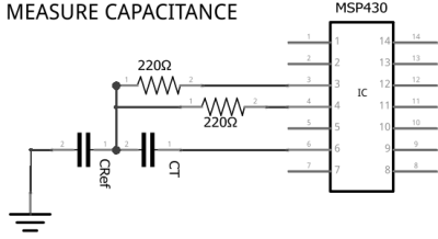

  • Hoi!
    Thanks again for your detailed reply and your time. I really appreciate your help.
    I tried to create the setup you suggested. See image!
    I use the following ports:
    • P1.1 for Measurement
    • P1.2 for Discharge (adc)
    • P1.4 for Charge
    This code for ADC setup:
    ADC10CTL1 = INCH_1;             // A1
    ADC10CTL0 = ADC10ON + ADC10IE;	// ADC10 On + Interrupt
    ADC10AE0 |= PinCapacitance;     // P1.1 ADC10 option select
    The following code for reading (in a while(1)-loop):
    // 1) Prepare for measure (discharge)
    P1DIR &= ~PinCapacitance;
    P1OUT &= ~PinDischarge;		// Make Discharge pin low
    P1OUT &= ~PinCharge;		// Make Charge pin low
    ADC10AE0 &= ~PinDischarge;	// Disable AE
    sleep(10000);
    // 2) Measure
    ADC10CTL0 |= ENC + ADC10SC;	// Enable ADC
    ADC10AE0 |= PinDischarge;	// Enable AE
    P1OUT |= PinCharge;		// Make Charge pin high
    while (ADC10CTL1 & BUSY) { }    // Wait for ADC
    adcValue = ADC10MEM;		// Read results
    ADC10CTL0 &= ~ENC;		// Disable conversion
    // 3) Clean
    The results:
    CT = *nothing*, CRef = 20pF, ADC = 916
    CT = 10pF, CRef = 20pF, ADC = 921
    CT = 20pF, CRef = 20pF, ADC = 928
    CT = 40pF, CRef = 20pF, ADC = 935
    CT = 100pF, CRef = 20pF, ADC = 955
    CT = 1nF, CRef = 20pF, ADC = 1020
    CT = 100pF, CRef = 10pF, ADC = 954
    CT = 40pF, CRef = 100pF, ADC = 961
    My questions:
    1) First of all, did I miss something in my setup or code?
    2) How I can stretch the values more? From 0..1023 (instead of 916..1021)?
    3) Is it possible to create a function out of these readings?
    4) Touching the CT capacitor doen't make any (visible) difference in the readings. Is that because of the limited reading-range?
    4) I'm measuring the ADC value in the CCS debugger (after measurement), does it influence the outcome?
    5) Currently i'm working with ceramic disc capacitors.
    Thanks!!
  • One quick note for now.
    You are enable ADC interrupts but doesn’t have an ISR for it, this can lead to a crash. Remove the ‘ADC10IE’.
    You have a changing reading according to the changed capacitor values, that already an improvement. But, agree, the readings are too high.
    For the CT=40p & Cref=100p it should be about 258.
    Do a test: Leave the Charge/Discharge ports low (P1.2 & P1.4) and start a ADC conversion.
    The result must be ‘0’. If not you probably have a analogue ground problem. Check if your analogue ground (to Cref) is not shared with the Vss wire but directly connected (closest) to the MCU Vss pin.

  • I looks like when I keep P1.2 & P1.4 LOW the adc-value is also 915 and not the expected zero!
    The Cref is directly connected to the GND (pin14) of my MSP430.
    So, maybe there was (already) something not correctly configured. Any ideas?
  • Analyzing your measurement values it looks like you have enabled the internal Pull-Up on P1.1 or P1.2!
  • Didn’t see your last post.
    This is weird, and can’t have to do with a pull-up, however the value fits with it.
    What voltage do you measure at the ADC pin?
  • Pull-up looks like disabled: P1REN = 0x00
    According to my multi-meter it's around 3.55V (USB powered launchpad)
    Just to make sure: When I directly connect my P1.1 to GND it read the expected ~0, and when connected to VCC it reads ~1023.
    So, I have the feeling it's some stupid setting I can't find! :)

  • There are a few unnecessary lines but for now they don’t harm.
    You are probably using the G2-Launchpad. Then remove the jumpers TxD & RxD, and try again.
  • I removed the 2 jumpers (TxD and RxD).
    What happens?! I get rather random values around 20..180 for (CT=100pF, Cref=20pF). I don't get it (yet)?
    Yes, some unnecessary lines, I have to clean it (getting a messy here).
  • Ok, but now you have solved the base of the problem.
    You are using very low capacitors, the influence of the wiring and also now your finger/hand will be big.
    First now try to get a stable reading/software with lager capacitors, let’s say a Cref from 1n till 100n, to reduce the influence of the pin and ADC capacitance.
    Maybe extending the ADC sample time can help.
    Or the order of the lines under ‘Measure’, maybe start conversion after setting the port’s.
  • Cool! You are a hero! I should buy you a beer! ;)
    btw: how did the TxD/RxD jumpers help me here? What did they block?
    I'm going to play around with this (difference caps sizes / times). Thanks a lot!
    Sounds good! When you have a good local beer, put it already in fridge for the case I’m maybe in the near.
    Port 1.1 (RxD) and 1.2 (TxD) are, via jumpers, connected to the emulator chip to provide UART serial connection via USB.
    When you have finished your software with calculation to a Capacitance value, you could post here the final result as a “MSP430 Capacitance Meter project”.
    You need to calibrate the system. If you use 100p capacitors for each CT and Cref you should read 512, but it will be lower. The difference is the wire, port and ADC capacitance, this you can calculate now and name it for example Csystem. From each capacitance calculation you have to deduct this value.
    Measuring these low capacitor values it’s possible that your AC line power have some influence. This you can compensate by measuring multiple times within your AC cycle time (50Hz=20mS, 60Hz=16.667mS) and average the value.
