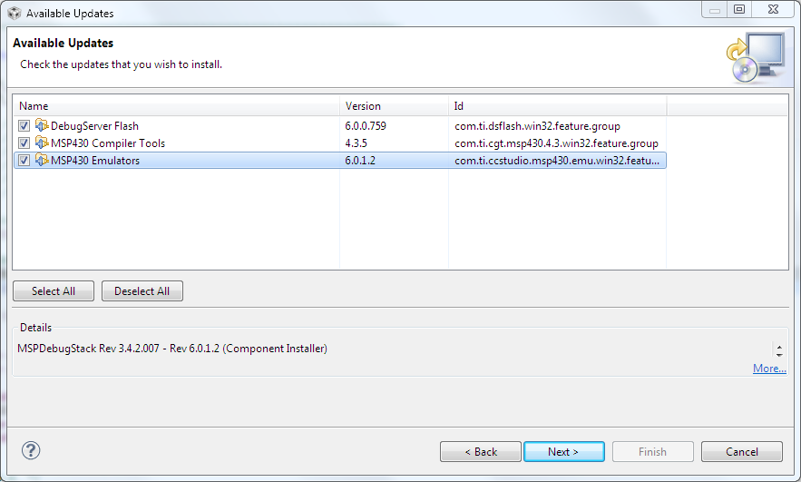

  • Hi William,
    Could you please check the #define __MSP430_HEADER_VERSION__ in your msp430fr4133.h
    You may need to install the latest msp430 related updates by going to:
    Help -> Check for Updates -> install
    After updates are finished, try a Rebuild Project and see if the problem persists. My msp430fr4133.h contains #define __MSP430_HEADER_VERSION__ 1153, and the project builds fine.
    E. Chen

  • Hellow y check for udpates and y clik  install ok .
    but my relice about msp430fr4133.h  is #define __MSP430_HEADER_VERSION__ 1139 ok
    Your relice is 1153 ok .
    But nothing change  ok .
    what y need to make ? for resolve these littly problem .
    Y MAKE 3 TIMES UDAPTES ONE INSTALL THE NEWS FILES .
    THE OTHER 2 TIMES NOTHng  FOR INSTALL ALL ARE instaled  OK .
    WHAT Y NEED TO MAKE NOW ????

  • Hi William,
    The header version 1139 lacks the LCDBMEM definitions that version 1153 contains. it is the root cause of your build errors.
    The newer header file should have been installed in the update:
    MSP430 Emulators 6.0.1.2 com.ti.ccstudio.msp430.emu.win32.feature.group Texas Instruments
    Please check the following file in your CCS installation:
    pathToYourCCSInstallation\ccsv6\ccs_base\msp430\include\msp430fr4133.h and make sure it contains LCDBMEM
    I've attached the latest header for you to verify: 7002.msp430fr4133.h
    Also, make sure to do a Clean Project before building the project again.
    Eric Chen

  • Hi William,
    Sorry, I was thinking that the MSP430 Emulators 6.0.1.2 was installed correctly on your computer based on the list of installed software you provided, and maybe the project wasn't picking up the updated include files. But it's apparent the new files did not get copied into your CCS.
    The new errors you are seeing after replacing the msp430fr4133.h is caused by a mismatch between msp430fr4133.h and msp430fr4133.cmd, which are both part of the many files changed in this software update.
    For a quick solution to the build error in this demo project, please back up the old files and copy/replace the following 3 files into this directory on your machine (be sure to remove the numbers preceding the file names):
    • http://e2e.ti.com/cfs-file.ashx/__key/communityserver-discussions-components-files/166/0250.msp430fr4133.cmd
    • 8713.msp430fr4133.h
    • http://e2e.ti.com/cfs-file.ashx/__key/communityserver-discussions-components-files/166/2364.lnk_5F00_msp430fr4133.cmd
    Note: This should be only be used as a workaround if the CCS MSP430 Emulators update fails to automatically replace these msp430 include files, since there are many other changes in this update. I would recommend reinstalling CCS and updates, making sure there aren't any install errors.
    Eric Chen
