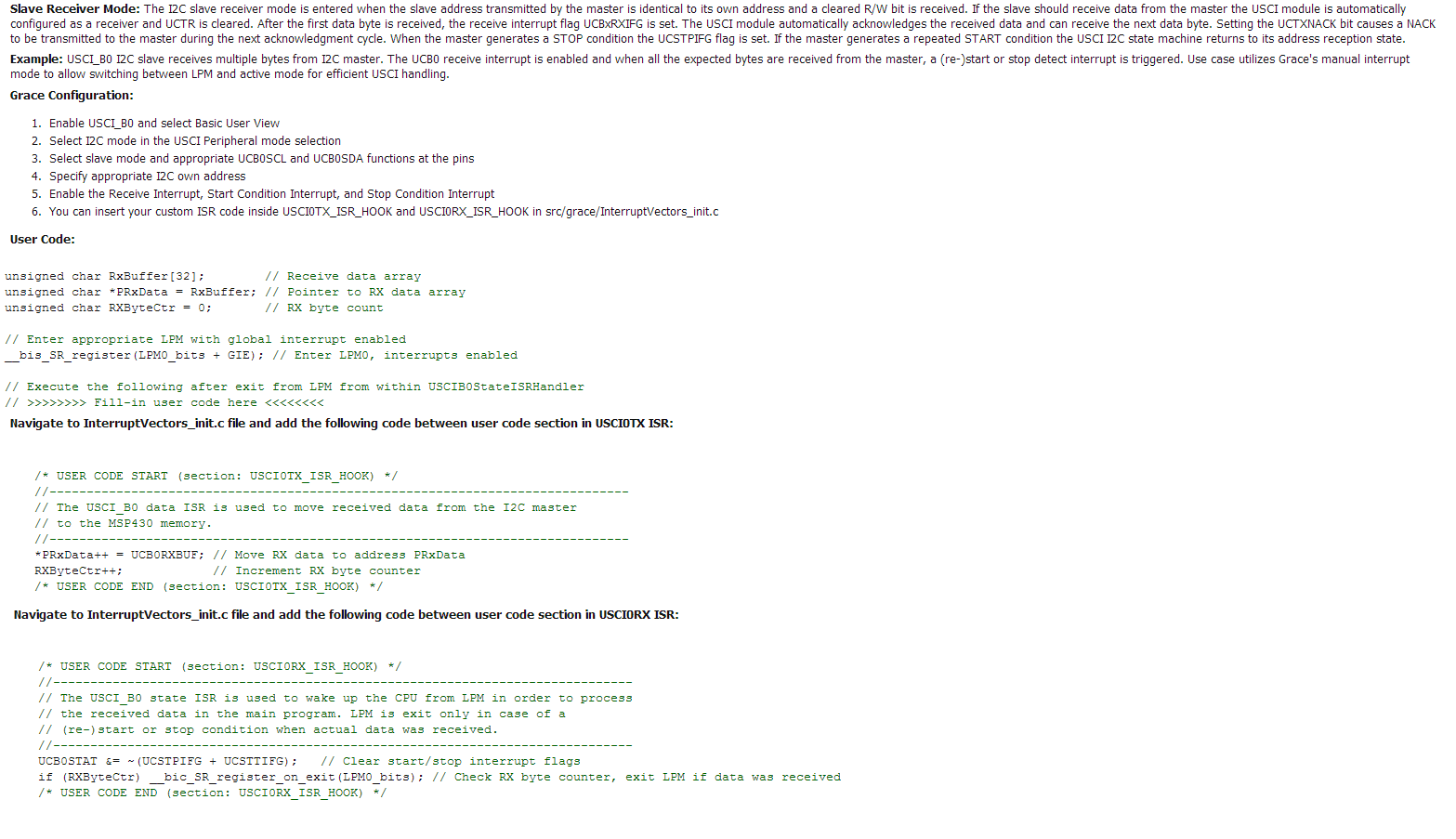

  • Dennis,
    Thank you for your help and I understand that you prefer not to use GRACE but I set-up the I2C communication using the suggestion given in the I2C section of the GRACE configuration interface. I have taken a screen shot of this and copied and pasted it below.
    Thanks again,
    Andrew

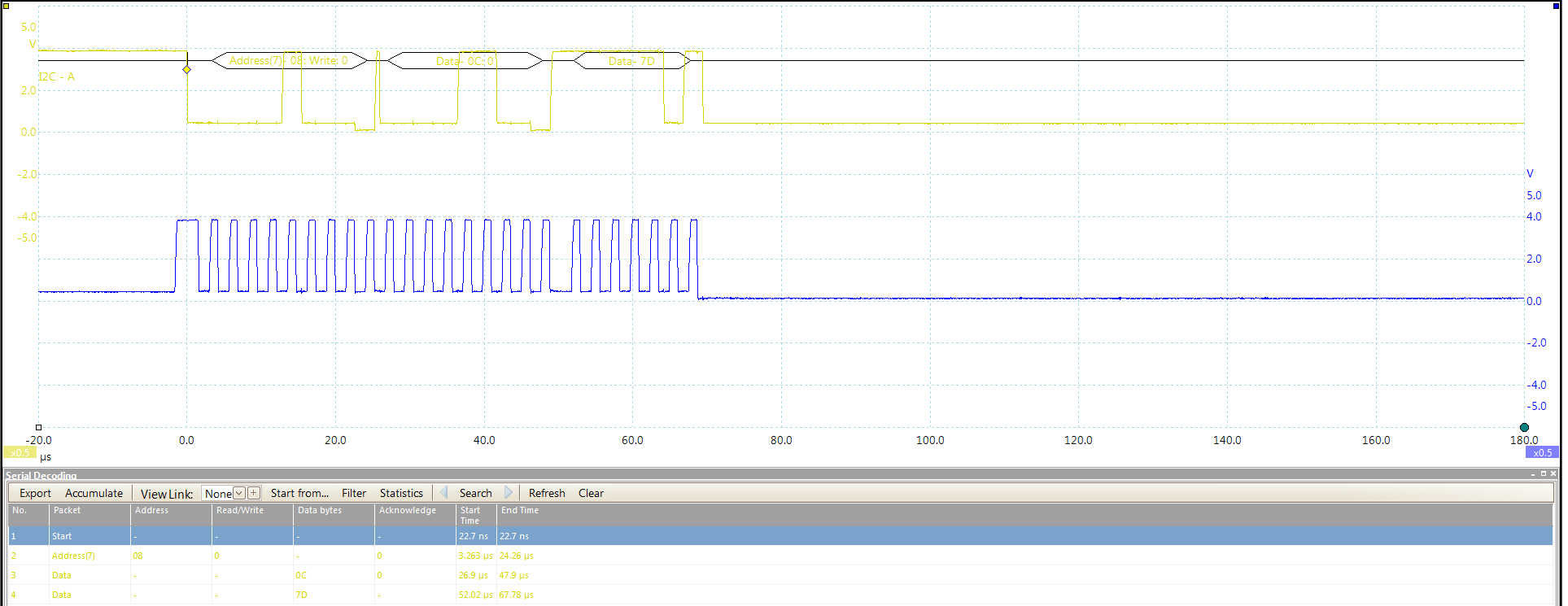

  • Dennis,
    I made the changes that you suggested and now I seem to have issues with the I2C now even though I did not change anything that has to do with that. I have attached my code below and a screen shot of my I2C bus.
    1538.PWMfromI2C.zip
