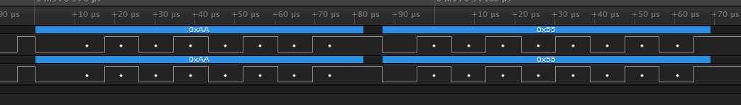

    It looks like the bad boards do indeed have a slower baud rate than the good ones. I made some captures with a logic analyzer I received yesterday, and it is obvious.  I can't figure out how to attach files to these posts, so I can't include the images unless someone tells me how.

    Here are the two screen caps. The bad one is first obviously. I had the same firmware on both boards. It look like the peripheral clock on the first one is just running slow.

    I was slightly worried about it not being entirely accurate, and maybe jittery, when I ran it at 20 MHz, but is it really possible that it could cause the kind of error seen in the above screen caps?
    And would there be that much variation between micros?
  • DCO variation is quite large across different micros even of the same type.
    The DCO also ha sonly 256 different frequencies (Which drift). Modulation produces 31 more average frequencies between these 256, and with a divider as large as you have, the average is fine.
    However, your problem is the RSEL range you picked. For RSEL_4, the DCO can be between 1.3MHz and 23.2MHz, but only 3.2to12.3MHz are guaranteed for all devices. Use RSEL_5, which has a maximum frequency of 6MHz for DCOx=0 and a minimum frequency of 23.7MHz for DCOx=31. So all devices will be able to produce something around 20MHz with RSEL_5. RSEL_6 would do too, and even RSEL_7 (but in this case, chances are that the FLL will settle with DCOx=0, which would set DCOFFG)
  • Changing to RSEL_5 seems to have fixed this board. I assume it fixed the rest also.
    Thanks for the help.
