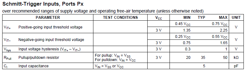

i need to know the the internal pull up & pull down resistor value .In datasheet it is given it is a programmable  only
  • Your understanding of the P1REN is not correct. By writing
    P1REN = 0x04;
    you enable the pull-up/down resistor for P1.2 - this does not mean P1.2 to be a pull-up and the other ones are pull-down. You enabled the resistor for P1.2, but the other pins still have their resistors disabled. In that configuration P1.2 is a pull-down, since the P1OUT register defines whether the resistor is a pull-up or down. P1OUT is 0x00 after startup and that leads to a pull-down. If you want to configure your resistor to be a pull-up you have to set the P1OUT bit as well by writing
    P1OUT = 0x04;
    P1REN = 0x04;
    The value of that resistor is 20k to 50k which can be found on page 24 in the datasheet:
