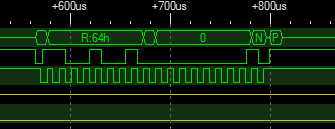

    on my logic port  i get this out. But the first byte shout be the address + a zero bit for writing onto the bus.

  • The logic capture you show above has the correct slave address. It also shows a read transaction from register 0, followed by a NAK.
    Are you trying to read from the part or write to it?
    If you are trying to write, you cannot write to register 0 on that LT part (reg 0 is read-only).

  • The capture shoult show a wirte process and i've tried to write 0x34 to 0x01 but the capture shows what came out.
    The operation is a read operation, it shows receiving of a 0x00 data byte. No information where it comes from, no reference to 'register 0'. it just shows that a data byte of 0x00 is received because the slave decided to send it.
