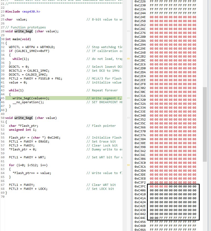

FWKEY+ERASE will erase 512 bytes of one segment, selected by 0xC24E address. However, 0xC24E is not first segment location, and writing of 512 bytes starting from 0xC24E will go over erased segment end, and will continue on next not-erased segment.
