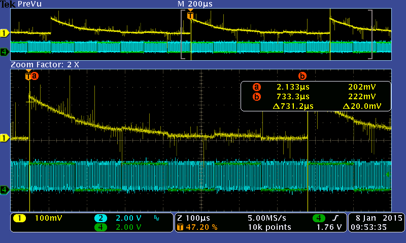

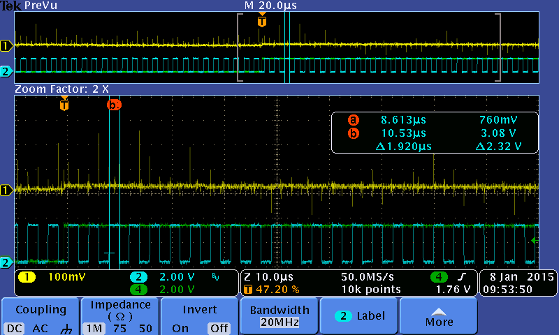

  • sorry that wasn't the right answer as I said before, I was looking at the wrong output pin. The debugging seems to be strage as the first time i run the program under debug stage nothing happens, but I I pause and restart I see waveforms on my Osc scope (pin setting and ADC sampling). Below are the wave forms I see.
    Yellow = ADC input A3, Blue is the toggling of pin 3.6 and Green is the output of the PWM for the timer (128 Hz toggle)
    The top capture shows the ADC seems to sample ~ 1.3 kHz (however there are glitches at 128 Hz in the waveform) and the bttom capture shows the toggling of pin3.6 at 530 kHz. Wehn running the scope as well the trigger is based on the PWM of the timer (green), but the ADC input (yellow) us not synchronous with this and shows a lot of jitter. There are only two things I can think which might be problamiatic. It either does not work in LPM3 which isnt suggested in the data sheet or when I tested it in active mode (using an infinite while loop) or a problem with the trigger. The data sheet (p66) describes the trigger as the TA1 CCR1 output, however I have no idea what this means as the CCR1 is a passive register, does it mean it compare the timer count to that of the value stored in CCR1, or that you cant use toggle mode as CCR1 is not taken into account in the PWM?
