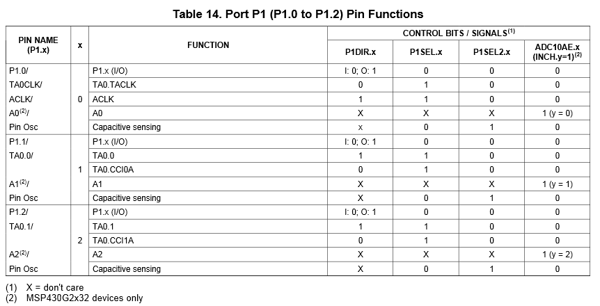

  • You should change the functionality of the default GPIO pin you are using for ADC input.
  • Refer some examples.
    there are plenty of examples in msp430ware driver library.
  • I do agree that only setting (SC | ENC) simultaneously seems to work. And I thought (from reading the manual) setting ENC once and start a sample via SC should do the job, too. But same behaviour in my experience.
  • Without Changing the default GPIO pin functionality ADC will not know which is input channel.
    so provide that and you will get your results
  • That's not correct. The pin is controlled by the ADC10AE.x bits which is set for bit 2 in the posted code.
    Look at table 14 on page 36 of the datasheet:
    The behaviour described has nothing to do with the pin-configuration.
    Dennis
