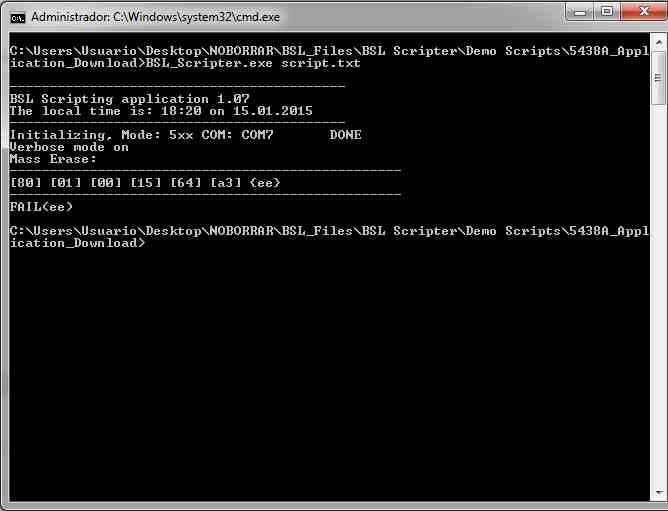

    I've tried the BSL-Scripter with the default firmware of the MSP430-BSL Rocket and I don't have success.  I run an example script only for view if the programm process starts on my CC430F5137, but nothing occurs. Only one fast reset at the beginning and then the CC430F5137 starts its normal program.
    BSL-Scripter screen:
    Initializing, Mode: 5xx COM: COM7       DONE
    Changing Baud Rate to 9601              FAIL
    Mass Erase:                             FAIL(
    RX Password:                            FAIL(
    Writing Big_File.txt to device: FAIL writing
    CRC from 5c00 of 4096 bytes to 982b     FAIL

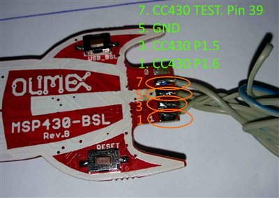

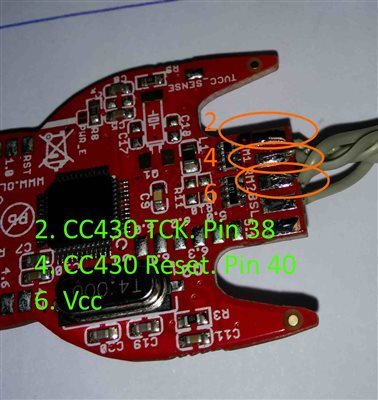

    The connections between the CC430F5137 and the Rocket BSL are:
    ROCKET BSL             CC430F5137
    BSL-RST                      #RST/NMI/SBWTDIO
    BSL-TCK                     PJ.3/TCK
    BSL-TEST                   TEST/SBWTCK
    BSL-TX                        P1.6/PM_UCA0TXD
    BSL-RX                        P1.5/PM_UCA0RXD
    VCC                              VCC
    GND                             GND
    I have been testing the continuity between all the signals and they are all OK.

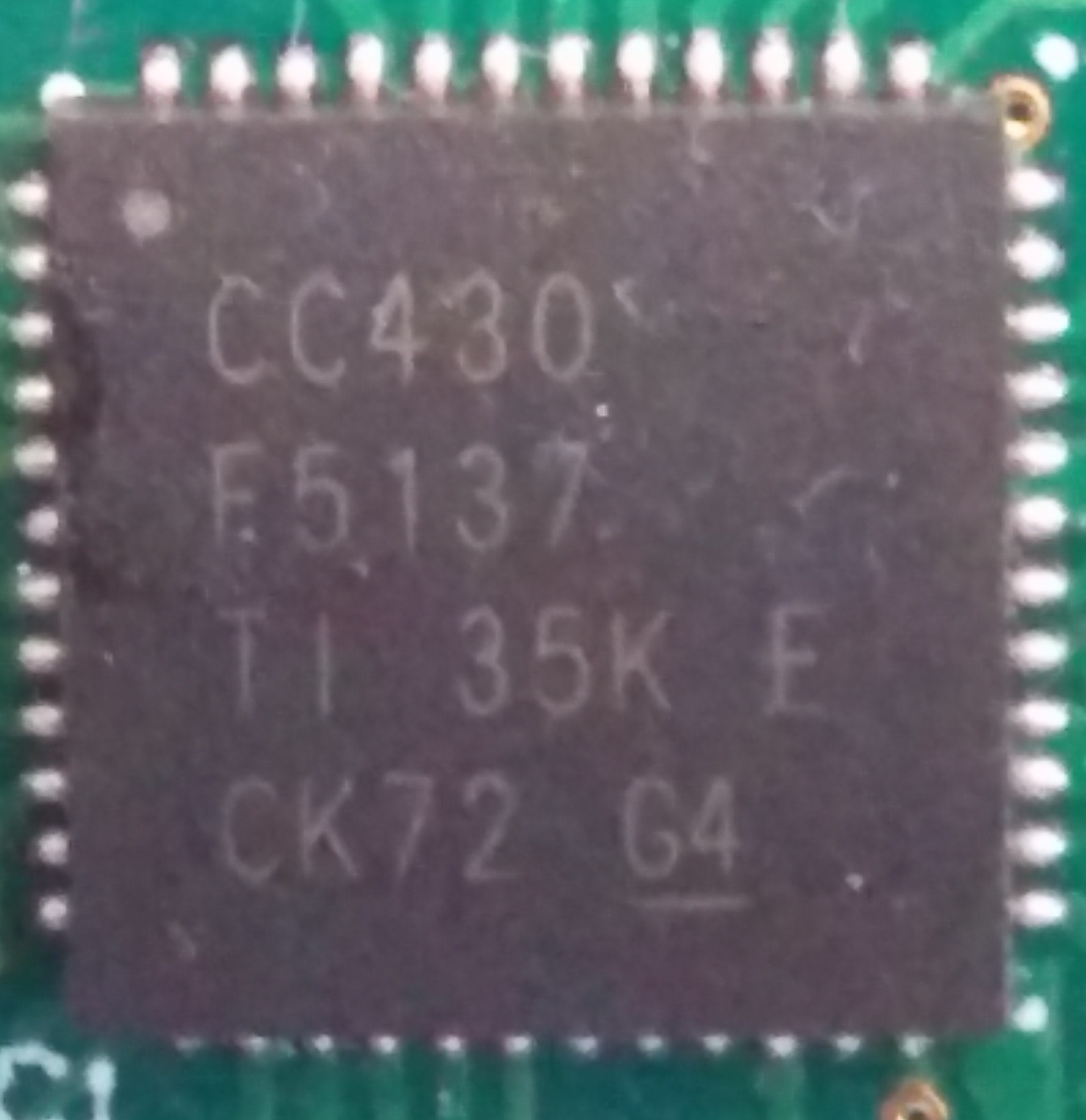

    So, in summary, at this moment I can't program the CC430F5137 with Rocket MSP430-BSL with any software tool like PYTHON MSP430.BSL5.UART, or BSL-Scripter.
     Could the problem be the CC430F5137?

  • Thanks again Katie.
    I use the simple script.txt:
    MODE 5xx COM7
    VERBOSE
    MASS_ERASE
    And the results are the same: FAIL

    I am using a custom board based on CC430F5137. Until now, I am programming and debugging it with the eZ430-EMULATION part of the TI Board MSP-EXP430F5529, as you can see in the attached pic, via CCS.
    Nevertheless, I want to program the circuit via BSL with a simple script ant TXT firmware, without running any platform as CCS or IAR.
    On the other hand, as you say, I have supplied the circuit with external power supply, and it still failing. Also, I quit the reset capacitor and doesn't run.
    Here is the connections that I have between rocket and my circuit:
    I guess that if I can program and debug my board without any problem with the TI FET, the lines of my circuit are correct.
    BR,
    Luis.
  • Hi Luis,
    You don't need TCK but the lines look OK.

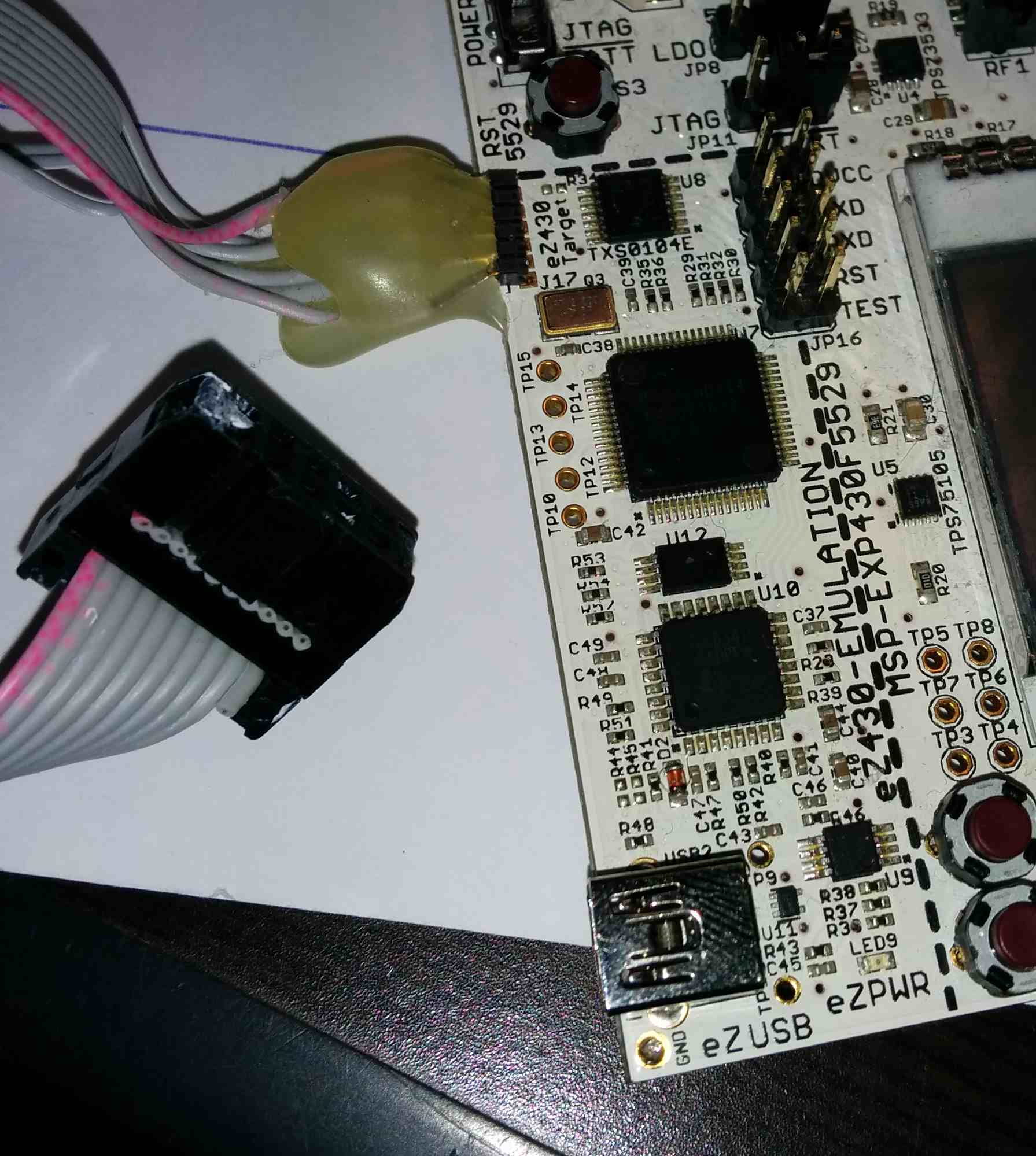

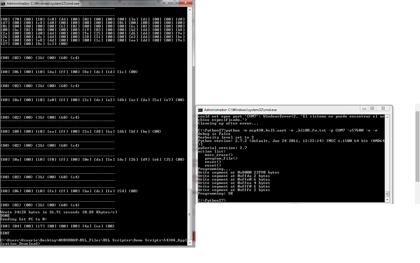

    Can you check the TEST+RESET lines with an oscilloscope? It also helps to load a simple LED toggle to the MCU (using JTAG) to check if the entry sequence is working or not. If the LED stops toggling, then the entry sequence is OK, and we would need to check the UART communication.
    Now, I tried using the Rocket with a EM430F5137RF900 and I had some problems with the entry sequence, but I'm not sure if that's because I'm using an old pre-release silicon. In any case, the problem got fixed when I changed the following line in uart.c:
    //Step 3
    //RESET LOW
    //TEST LOW
    //TCK HIGH
    PJOUT = TCK_PIN;
    //Delay(20);                            // This smaller delay is due to bug SYS10 of older Revs/devices like F5438A Rev G
     Delay(INVOKE_DELAY);    // Increasing the delay seems to work for CC430
    Here are the updated binaries if you want to try them:

    The revision of my CC430F5137 chip is E.

    I've tested removing the 100 Ohms resistors and bypassing them on the BSL lines of ROCKET and it works properly with the MASS ERASE script. But, as it happens above, the firmware programming doesn't work, even the mass erase step.
    Until tomorrow I won't be able to do new tests, so what do you think about the failing of the programming script. Is it an electrical problem on lines? Or is it the script? Vcc and GND is ok, I have 3.3Vdc stable, and the length of the tracks are not long enough to have a large impedance that could produce electrical interferences.
    My program script is:
    MODE 5xx COM7
    VERBOSE
    MASS_ERASE
    RX_DATA_BLOCK my_firmware.txt
    Removing the last line, it works.
    BR,
    Luis
  • Hi Luis,
    It looks like your programming script is missing the RX_PASSWORD command before calling RX_DATA_BLOCK. RX_DATA_BLOCK is a password protected command. So try simply adding the line "RX_PASSWORD" between the MASS_ERASE and RX_DATA_BLOCK lines of your script.
    Katie

    1. After viewing the electrical problems in the UARTs lines, I have removed all the 100Ohm resistors from the Rocket. Cause I have shared the UART lines with a RS485 chip, this could be the source of the electricals problems. Removing the 100Ohm impedance in lines, I resolved it.
    2. I have the next connections:
    BSL-RST(4)                #RST/NMI/SBWTDIO
    BSL-TEST(7)              TEST/SBWTCK
    BSL-TX(1)                   P1.6/PM_UCA0TXD
    BSL-RX(2)                  P1.5/PM_UCA0RXD
    VCC(6)                        VCC
    GND(5)                        GND
    3. With python tools I haven't been able to program the CC430F5137, I've used BSL-SCRIPTER.txt (http://www.ti.com/lit/zip/slau319).
    4. In my script, for downloading a firmware, I have had to put the Baudrate below or equal to 19200 in the first line after the MODE line. For larger baudrates, it doesn't work. For example, my script was:
    MODE 5xx COM7
    VERBOSE
    CHANGE_BAUD_RATE 19200
    MASS_ERASE
    RX_PASSWORD
    RX_DATA_BLOCK my_fw.txt
    If I don't put the baudrate, BSL-SCRIPTER doesn't run properly.
    I hope this would be a help for anybody with my same problems.
    Thanks a lot, Katie and Luis!
    PD: (My last questions!)
    Could it be possible to use the rocket bsl and CC430 with the python tools?
    And, how could I increase the baudrate upper than 19200 for programming via UART BSL?
    BR,
    Luis
  • Hi Luis,
    From what I can see, the python script doesn't force a baudrate of "9601" which is what triggers the rocket to generate the entry sequence.
    First of all, install this patch which should fix some problems: https://bugs.launchpad.net/python-msp430-tools/+bug/1258574
    After that, I added the following in start_bsl inside uart.py:
           self.set_TEST(True)     # TEST pin: GND
           time.sleep(0.250)       # give MSP430's oscillator time to stabilize
           time.sleep(0.010)
           self.serial.baudrate = 9601
           time.sleep(0.250)
           self.serial.baudrate = 9600
           self.serial.flushInput()    # clear buffers
    I tried running the script as shown below and it worked:
    > python -m msp430.bsl5.uart -e LEDToggle.txt -p COM19 -v

  • Hi Luis!
    Regarding the first post:
    Changing uart.py and bsl5.py, the msp430 python tools works now programming CC430 via Rocket msp430-bsl, but it has an odd performance. I mean that it works properly only when I execute the commands after a few moments behind resetting BSL rocket. If I connect the rocket BSL to my CC430f5137 circuit and pass more than a second, the python command doesn't runs: my circuit runs normally and never puts in BSL mode. I think that it could be any wait function or something like that. In addition, when I program the new firmware succesfully, my circuit never go out from BSL mode, even with parameter -r. This means that Rocket BSL maintain the reset line low.
    This test has been done under Windows. Under linux, my python 2.7 don't recognize several lines of the files patched and makes impossible the running of msp430 python tools, so I haven't  been able to program CC430f5137 under Linux. I think that the problem would be in the port selection, because it is different depending on OS.  I have the problem that I don't know anything about the python coding.
    With referent to second post, your firmware has enabled baudrates upper than 19200, although in BSL-SCRIPT I don't notice the new baudrates: it continues being slow. With python tool yes I notice it: is faster than bsl-scripter. Configuring baudrate at 57600 bps, with a 24KB firmware BSL-Script needs 26 seconds. On python tools, the programming takes below 10 seconds.
    With both tools, after programming, the circuit isn't reset: I must power off and then power on the circuit for start the firmware.
    Thanks again, Luis.
    BR,
    Luis
